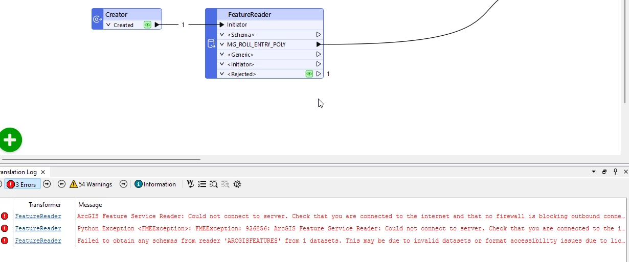

Error message:
ArcGIS Feature Service Reader: Could not connect to server. Check that you are connected to the internet and that no firewall is blocking outbound connections. The error was 'HTTPSConnectionPool(host='services.arcgis.com', port=443): Max retries exceeded with url: /mMUesHYPkXjaFGfS/arcgis/rest/services/ROLL_ENTRY/FeatureServer?f=json (Caused by SSLError(SSLCertVerificationError(1, '[SSL: CERTIFICATE_VERIFY_FAILED] certificate verify failed: Basic Constraints of CA cert not marked critical (_ssl.c:1028)')))'
Python Exception <FMEException>: FMEException: 926856: ArcGIS Feature Service Reader: Could not connect to server. Check that you are connected to the internet and that no firewall is blocking outbound connections. The error was 'HTTPSConnectionPool(host='services.arcgis.com', port=443): Max retries exceeded with url: /mMUesHYPkXjaFGfS/arcgis/rest/services/ROLL_ENTRY/FeatureServer?f=json (Caused by SSLError(SSLCertVerificationError(1, '[SSL: CERTIFICATE_VERIFY_FAILED] certificate verify failed: Basic Constraints of CA cert not marked critical (_ssl.c:1028)')))'
Failed to obtain any schemas from reader 'ARCGISFEATURES' from 1 datasets. This may be due to invalid datasets or format accessibility issues due to licensing, dependencies, or module loading. See logfile for more information
I even have the Rejected Feature Handling to Continue Translation.

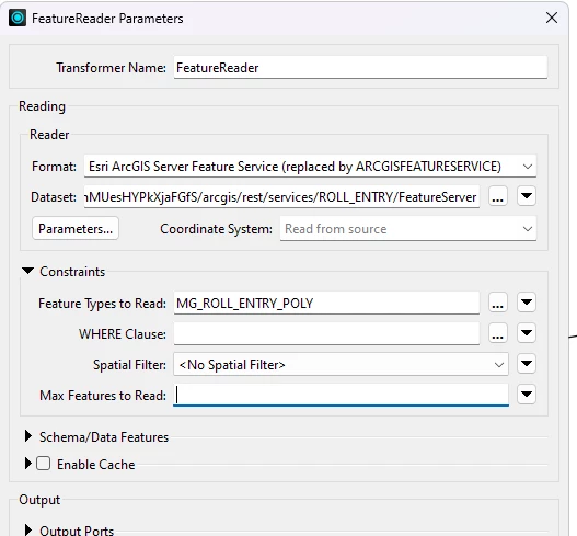

FeatureReader setup which worked perfectly fine in FME 2022.2 but not in FME 2025.1
I’ve tried the following format but its configuration for a web connection is not needed, since the REST feature service URL I’m accessing does not require a username nor password https://services.arcgis.com/mMUesHYPkXjaFGfS/arcgis/rest/services/ROLL_ENTRY/FeatureServer

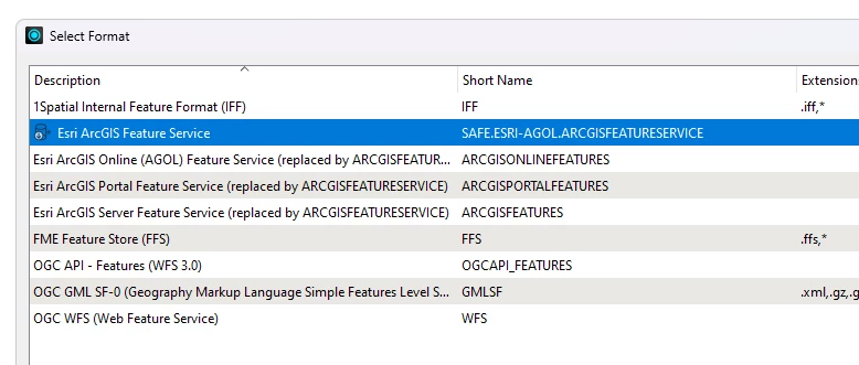

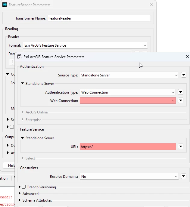

If you set the "Esri ArcGIS Feature Service” (safe.esri-agol etc. ) to Standalone server you can pick Authentication = None.

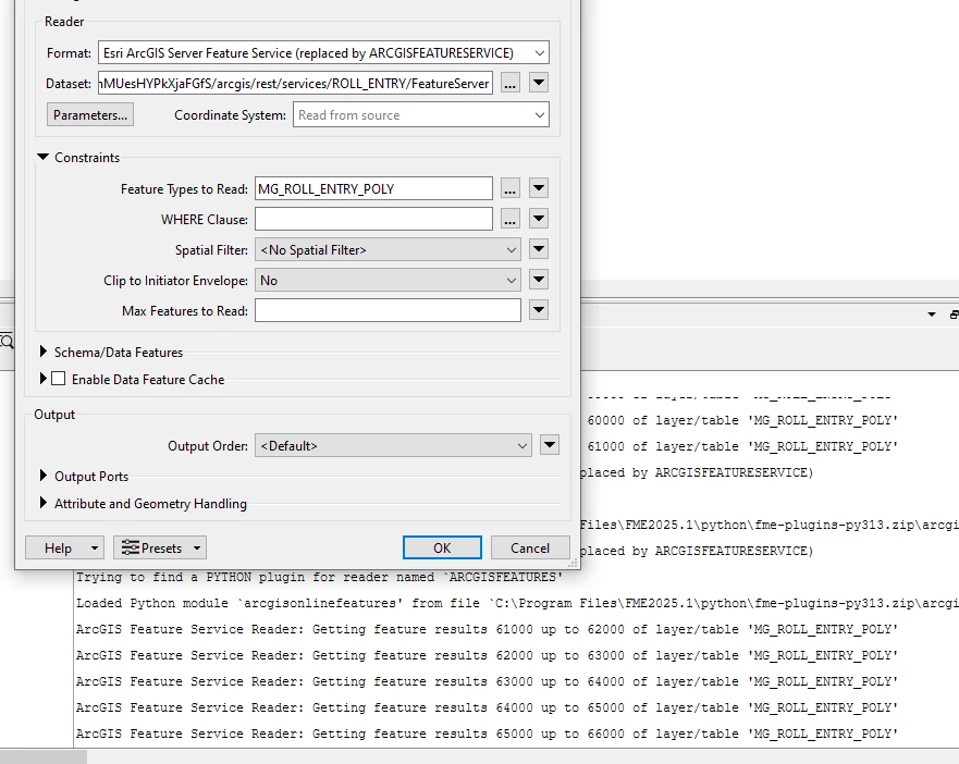

This is my result as well:
ArcGISFeatureServiceReader: Getting feature results 1000 up to 2000 of layer/table 'MG_ROLL_ENTRY_POLY'
So seems to be working.
Both with the (replaces by ARCGIS) format and the (safe.esri-agol) format.
I do notice that the FeatureReader ignores the Max Features to Read parameter. And I did not want to wait for all the results to show up.

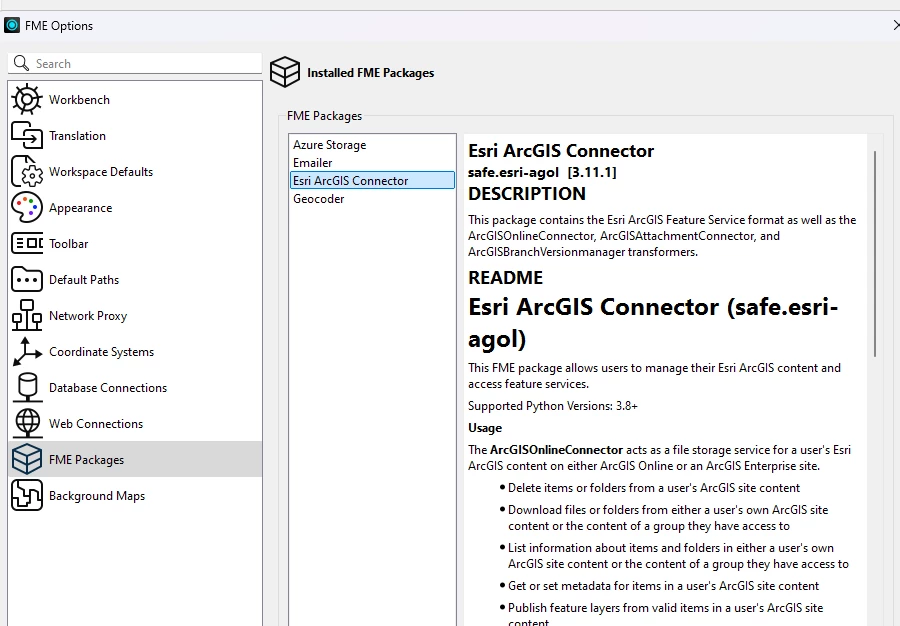

No issues with the SSL on my machine. I also have the safe.esri-agol [3.11.1] installed on 2025.1.0.0 FME Form.

I ended up switching to Esri ArcGIS Feature Service” (safe.esri-agol etc. ) and Authentication set to None which worked fine. For some reason, the other format (replaces by ARCGIS) is still returning errors. I’’ stick with Esri ArcGIS Feature Service” (safe.esri-agol).
