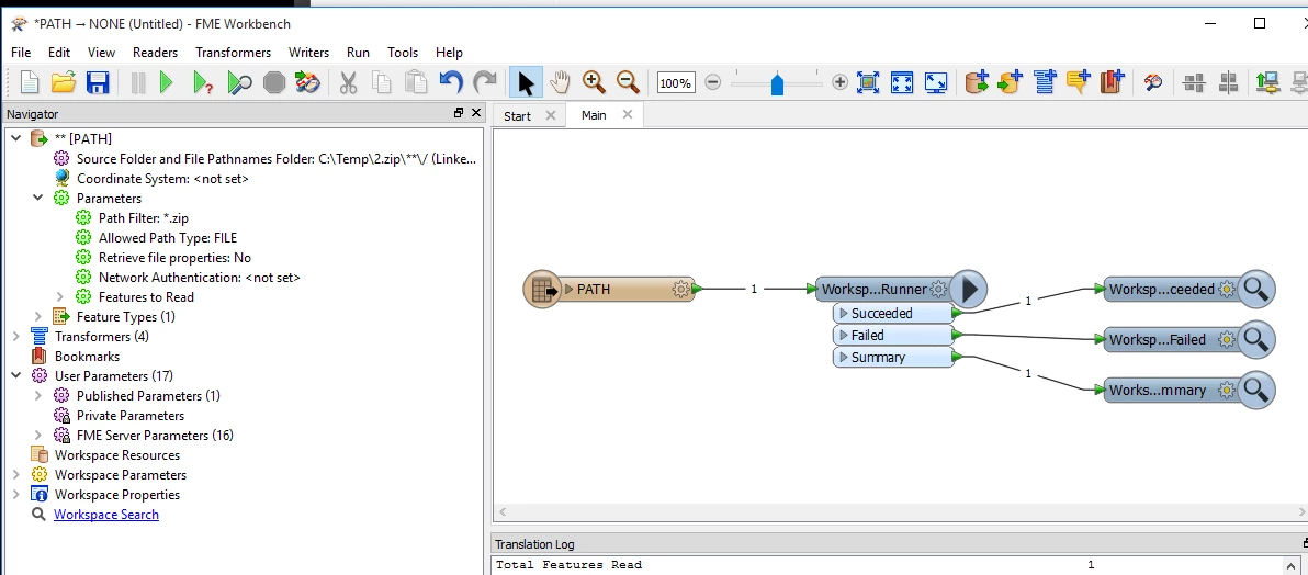

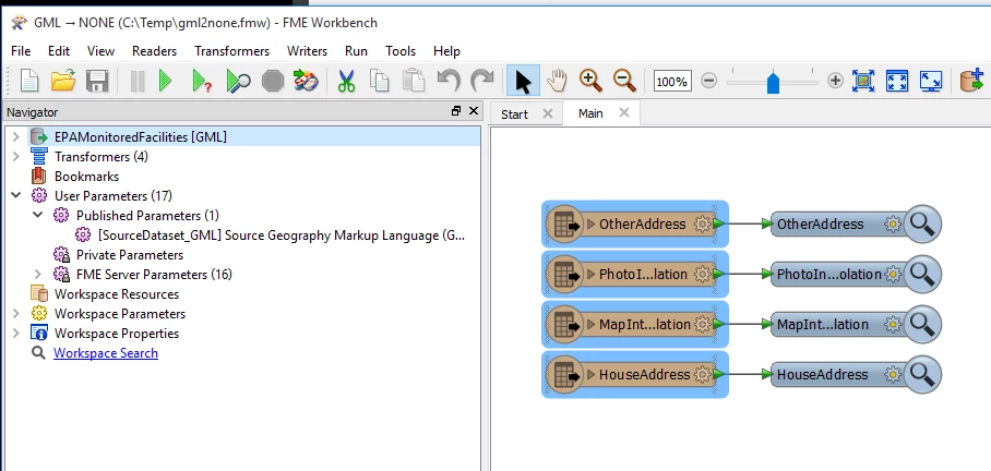

David,
You can use the following:
Create a workspace reading the GML.
Create a master workspace using the Directory and Filepath reader like in the picture.
I tried this and it works:

erik_jan
Forum|alt.badge.img+26
  • Jan 29, 2016 8:36 PM UTC
David,
@1spatialdave Did you ever get it to work this way. I used it to process over 300K GML files (nested zipped) and it works without unzipping.
