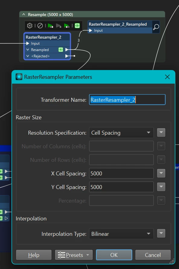

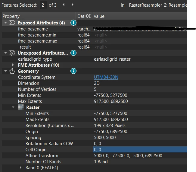

  2. Resample the 3rd raster to the cell spacing of the other two (5000 x 5000)
Raster 1
Raster 2
Resampled Raster 3

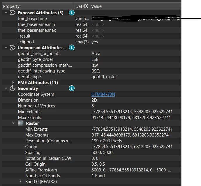

  1. Clip the 3rd raster to the extent of the other two:
  • I use RasterExtentsCoercer for one of the first two raster’s (as they have identical extents). Set extents type to ‘Data Extents’. As I want the data extent clipping not the outer extent rectangle. Then using clipper with the output of RasterExtentsCoercer as ‘Clipper’ and resampled 3rd raster as the ‘Candidate’. It is the ‘Inside’ output I want.
  • The output is visually what I would expect here but the min and max extents don’t match the extents of the ‘Clipper’ i.e. the output of RasterExtentsCoercer

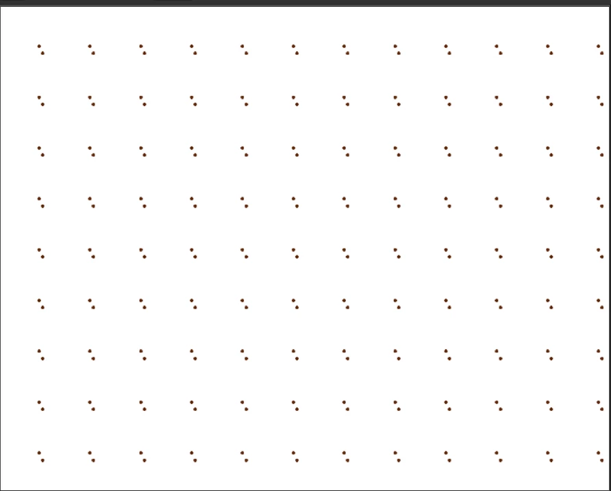

  1. By using RasterCellCoercer and CenterPointReplacer, I mapped the center points of the original raster 1 before the RasterExtentsCoercer, and the output of the Clipper to understand the misalignment:
  • As you can see the center points of the original and clipped raster’s aren’t identical. This causes RasterBandCombiner to fail. Which is my end goal.

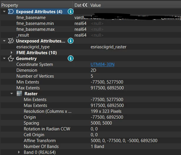

In summary the min and max extents of the original Raster 1 and Raster 2 and the clipped Raster 3 (to the extent of Raster 1&2) is not identical:
Clipped Raster 3:
Raster Min X = -77854.55513918214
Raster Min Y = 5348203.923522741
Raster 1 & 2:
Raster Min X = -77500
Raster Min Y = 5277500
Is there a way to force Raster 3 to have the same extent as Raster 1 & 2?

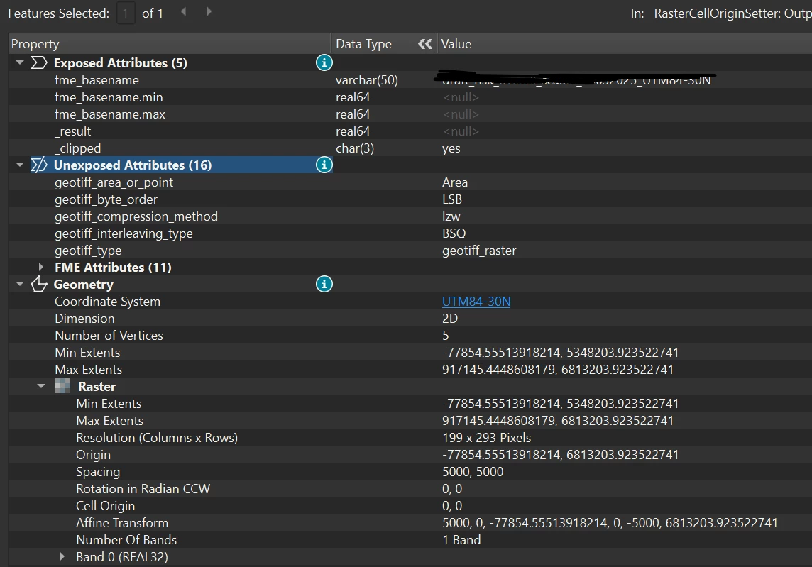

Hi ​@nielsgerrits, Sorry I forgot to mention this in my question. I did use RasterCellOriginSetter to reset the cell origin of clipped Raster 3 but the extents remained mis-aligned:
Output from RasterCellOriginSetter (Clipped Raster 3)
Thank you though! I appreciate your reply :)
