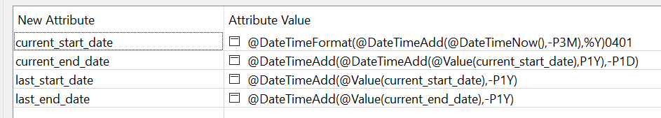

Best answer by ebygomm
To get the current regulatory year you need to take away 3 months not 9
So current regulatory year start date would be
@DateTimeFormat(@DateTimeAdd(@DateTimeNow(),-P3M),%Y)0401
From there you can calculate all the other dates
