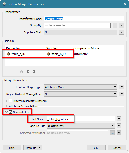

david_r
  • Sep 25, 2018 7:24 AM UTC
Sounds like you want the FeatureMerger with the generate list-option
See the docs: https://docs.safe.com/fme/html/FME_Desktop_Documentation/FME_Transformers/Transformers/featuremerger.htm
