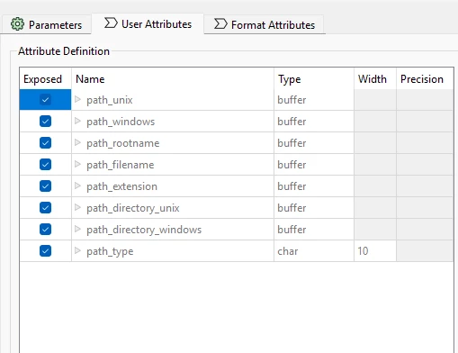

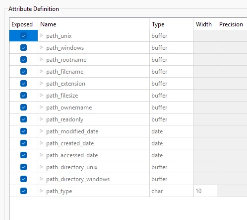

Hi, I am currently trying to do this process but have noticed that I am unable to expose the same attributes as what are exposed on the example workspace provided. These are exposed on provided workspace
And this is what I am able to see on mine
I’ve tried different directories and drives, but I still get the same error. Is this something that I am doing incorrectly or could it be related to our IT settings?

Hi ​@katie.grey
You may find this post helpful: path_modified_date and Directory and File Pathnames Reader
In the Directory and File Pathnames Parameters set Retrieve file properties to yes.
