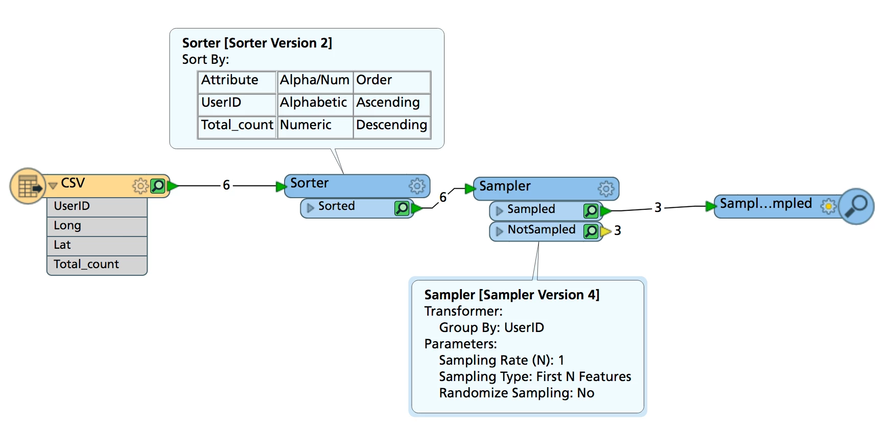

Hi, I have a dataset of point like this
UserID Long Lat Total_count
001 1 1 13
001 2 2 1
002 3 3 20
002 4 4 2
003 5 5 30
003 6 6 5
How can I pick only the user with maximum total count and keep the long/lat attributes in the output?
Best answer by redgeographics
If you sort on UserID and Total_count and then use a Sampler, grouped by UserID to sample the first feature you end up with
001 1 1 13 002 3 3 20 003 5 5 30
That's what you want, right?

Nice and simple, @redgeographics. I was thinking way to complicated.

Thanks @redgeographics. Exactly what I want

Hi @redgeographics
how about if I want to pick out the userID with 1 row only. For example
USerID        Long           Lat              Count
001                1                1                    20
001                2                2                    1
002                3                 3                   5
003                4                  4                   20
003                5                   5                   6
004                6                    6                  9
I need to pick out the userID 002 and 004
