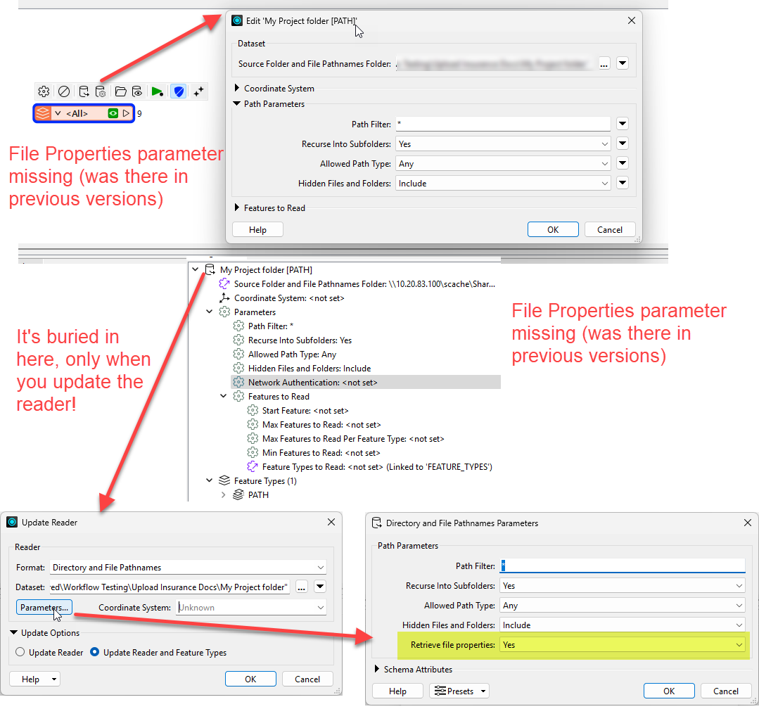

You need to specifically activate the appropriate setting in the reader for this:
The reason is that requesting this information from the file system can have a performance penalty on some systems, especially for a large number of files.
dbaldacchino1
Forum|alt.badge.img+14
I was testing FME 2025.1 Beta and it seems this setting is either hidden on purpose or there’s some bug. It’s kind of buried...is this intentional you think? It’s available when initially placing the reader, but not when editing the the parameter settings from the reader after the fact. You have to right-click in the Navigator to update the reader to get to it (also not visible in Navigator).
david_r
  • Jun 12, 2025 7:37 AM UTC
That’s weird. Might be unintentional. Consider signalling it to Safe.
dbaldacchino1
Ticket created, filed internally as a bug
