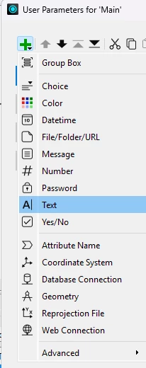

With user parameters being used in the custom transformer you have, did you assign a parameter type? for example are they all text, or file/folder/url
user parameter types
The type of user parameter will change the UI prompt experience

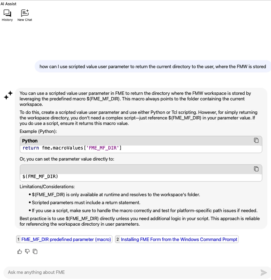

You will need possible to use python scripted value to derive the directory path to the prompted user
advanced user parameter types
To achieve what you’re after, I asked the AI assistant. It suggested using python
return fme.macroValues['FME_MF_DIR']
But alas I’m not sure this will work..

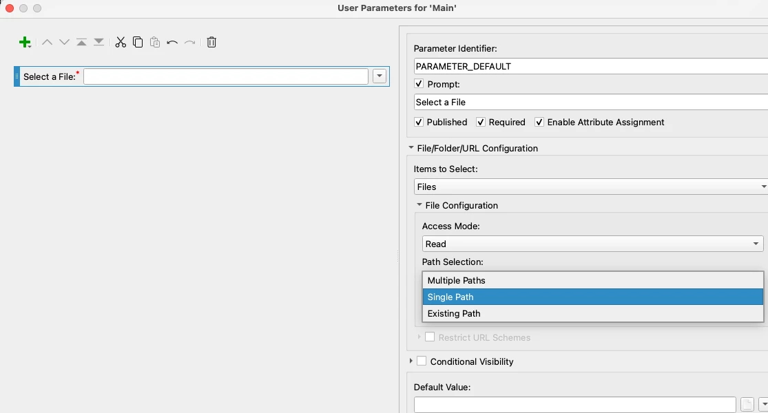

maybe you can explore using the File configuration options to access Single path and specify the extension filters to only allow the user to pick certain formats
https://docs.safe.com/fme/2025.1/html/FME-Form-Documentation/FME-Form/Workbench/published_private_parameters.htm
