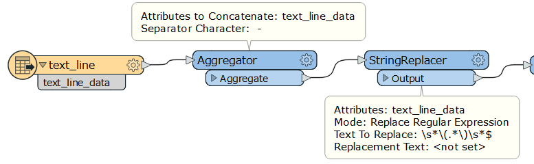

In reader we have below cvs with one field.
Translation was SUCCESSFUL
9.4 seconds. (CPU: 4.2s user, 2.7s system)
How I can get this in text like this: "Translation was SUCCESSFUL - 9.4 seconds."
May be regex or something else

  • Jul 25, 2019 10:33 AM UTC
The following regex should match everything before the brackets which you could use in a string searcher
Or you could use a stringreplacer to replace everything in the brackets and including the brackets with nothing

How I can merge to one line data in different rows. I want like this - "Translation was SUCCESSFUL - 9.4 seconds." . In one string
  • Jul 25, 2019 11:42 AM UTC
You can use the string replacer to do this, by replacing the line feed/carriagereturn with a space
If the source text just contains the two rows, you can achieve the goal with this workflow.
