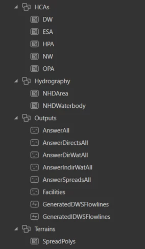

I have a file geodatabase that contains several feature datasets.
Here is what I need to do......The AnswerAll point feature contains over 5000 rows, however I need to "select by attributes" using Comp_Name.......this yields me 376 results each with a varying number of rows for each Comp_Name.
I then need to take the HCA Name from each of these rows and find the corresponding HCA polygon in my HCA's dataset.
Once I have the HCA Names and there associated polygons for each Comp_Name, I need to create a Bounding Box Polygon around those Polygons, and export it out with the Comp_Name, HCANames, and HCATypes
I can attach my geodatabase if anyone wants to take a crack at this!

So I have updated my geodatabase a little, so that all my HCA polygons are in one feature class.
Here is what I am doing in ArcGIS Pro, and trying to replicate here.
I select features by attributes from the AnswersAll data layer using the Comp_Name
I have a created a relate to relate the HCAs layer using the HCAName to the HCAName in the AnswersAll layer.
I select the features in the AnswersAll Layer and Then select the related data from the HCAs layer.
I then need to buffer the HCA data by say 10ft, dissolving the feature into one polygon.
I will need to iterate through the AnswersAll data to do this for all the Comp_Names and create Buffers for Each one with the Output being named by Comp_Name.
Of course I realize this will give me almost 376 buffer features, I could eventually combine them into one feature dataset.
Let me know if anyone can help me with this.
