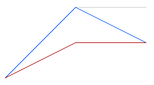

Just be aware there is a case that the result with the CoordinateReplacer is different from the result with the VertexCreator, since the CoordinateReplacer modifies coordinate elements (x, y, z) independently according to each pair of Find and Replace.
Red: CoordinateReplacer, Blue: VertexCreator, Gray: Original Line
