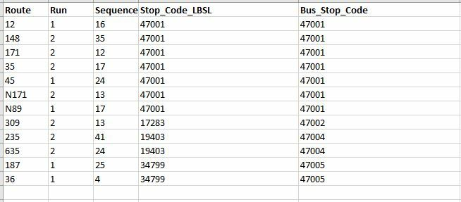

I have a CSV file showing Bus Stop Codes in one column and Bus Route Numbers in another column.
As you can see there are multiple Bus Stop Codes for each Route..

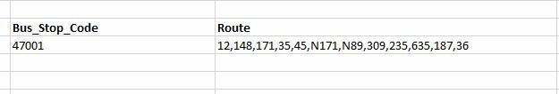

I want to create a table which shows the following
I am very new to FME and only learning the basics. Is there an easy way to do this in FME for all the Bus Stop Codes ??
I've attached an example CSV file

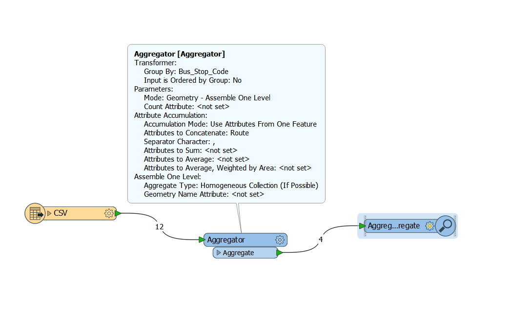

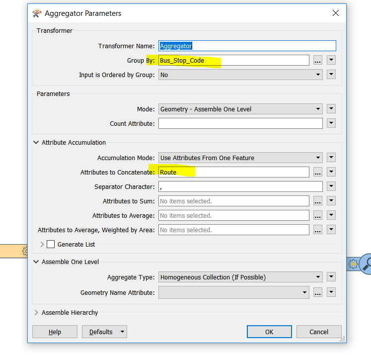

Hi @obrienor
You can use the transformer Aggregator like this image:
Configurations - Group By: Bus_Stop_Code and Attributes to Concatenate = Route
Thanks,
Danilo
  • Apr 25, 2018 3:29 PM UTC
hI @danilo_fme
This worked so well... thank you so much for your help.
