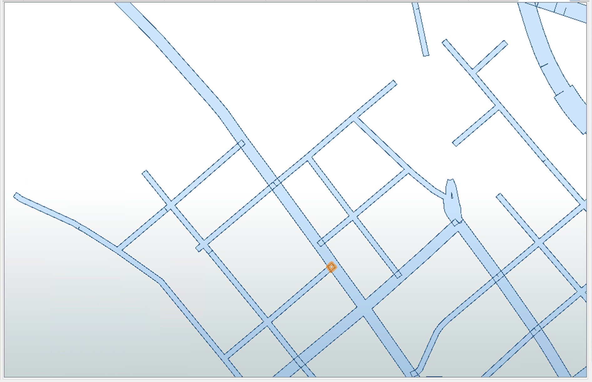

I have set of polygons representing streets like in the image below. I want to merge small polygons like the selected orange polygon to their bigger container polygon.
I do not know how to do this with FME. What would be a good approach?
Thanks for any help!

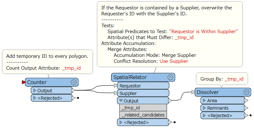

takashi
  • Jul 24, 2019 11:22 AM UTC
Hi @oiram, if I understand the requirement correctly, this workflow does the trick.
Excellent, this works nicely.

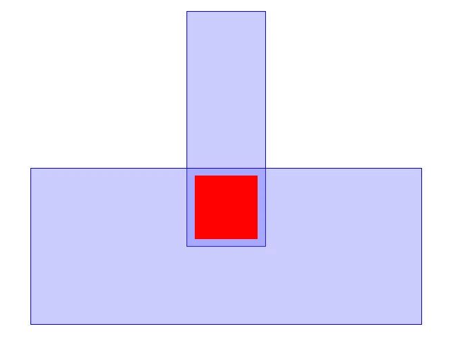

I'm unclear exact situation of the original dataset. Is a small polygon (red) within an overlapping area of two large polygons (blue), like this?

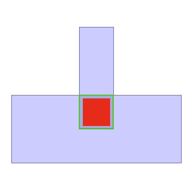

No, the small polygon is on the borders , like the green square. It's created by an AreaOnArea overlay of the two streets which have an overlay in the original dataset. In the solution above, the green square becomes part of the vertical polygon and the horizontal is cut out (clipped) in this area. I would like it to be part of the horizontal, bigger blue polygon, so that both are still rectangles in this example.

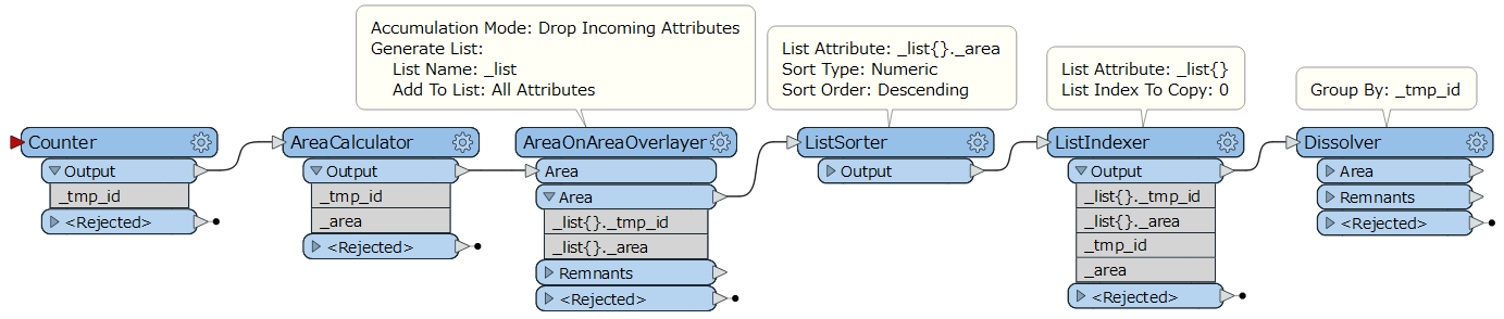

OK. After calculating the area for every original polygons with the AreaCalculator, you can achieve the goal with this workflow including the AreaOnAreaOverlayer.
Forum|alt.badge.img
  • Jul 25, 2019 9:33 AM UTC
Excellent, this works perfectly.

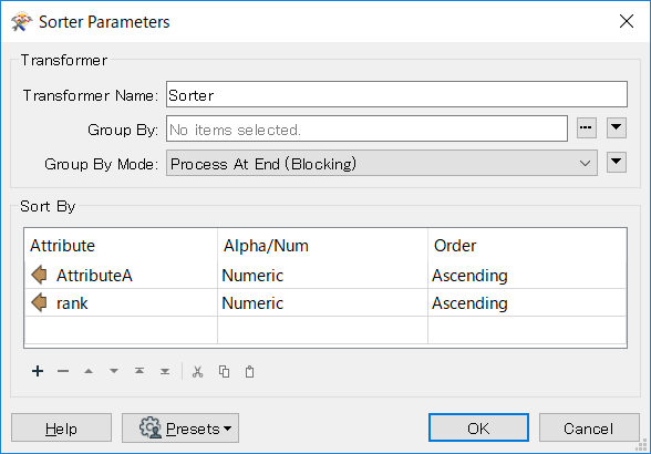

One last question: Is it possible to sort on the list based on two attributes? Meaning, if the first criteria to sort is equal on two attributes, take a second to rank them?
featureattribute Aattribute BrankA1081B1052
  • Jul 25, 2019 10:11 AM UTC
Unfortunately, the list sorter doesn't currently allow sorting by multiple attributes

takashi
  • Jul 25, 2019 10:47 AM UTC
You can use the Sorter instead.
