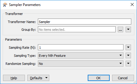

If you just want the max, the simplest way is to sort by COST in descending order and then use a sampler to sample the first feature. This will be the feature with the max value and the value in COST will be the max

could please brief in
  • Sep 18, 2019 1:03 PM UTC
You just need to change the Sampling Type to "First N Features" and keep the sampling rate as 1
