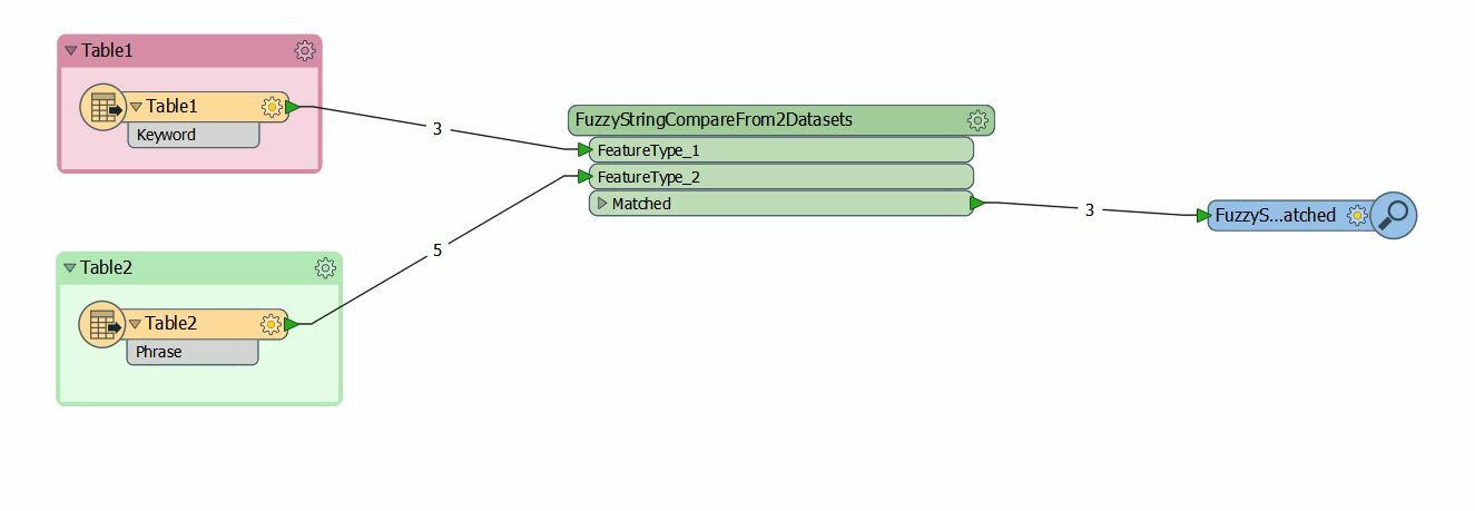

I created for example two datasets xls.
  • Table1
  • Table2
Inside on file Table1.xls it was created 3 values from attribute Keyword:
  • Residential
  • Local
  • Soccer
And in the Table2.xls it was created a atttribute called Phrase with 5 values:
  • Residential and commercial
  • I live in this local
  • I love volley
  • We play soccer
  • Sunday is great
In Canvas ( FME Desktop Workbench ) I used the custom transformer :FuzzyStringCompareFrom2Datasets

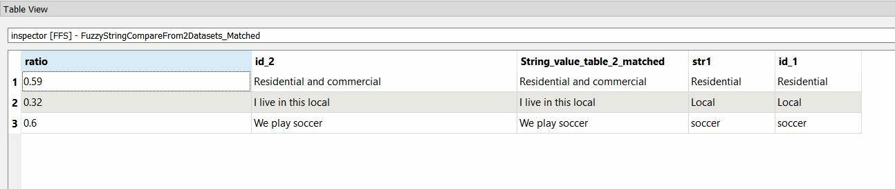

The results was just 3 in commum between two Readers:
I hope that it'll help you.
Attached the Workspacec template file. Workspace_Keywords.fmwt
Thanks,
Danilo

@danilo_fme
YES DID WORK FOR ME
THANKS
