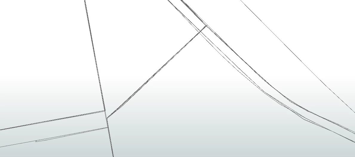

I have 600+ bus lines that I need to make a single network from containing just the lines/roads the buses uses. The problem is that mostly the bus lines are made following a road network making all lines on most roads 100% parallel. But on not so few places the road network is missing so on those places the bus lines are hand plotted making them not parallel at all. Lines changes and this should therefor be updated two to three times annually. How can I use FME to automatically create those missing roads not in the road network out of the different hand plotted lines? Sometimes just one, but mostly 5-10 closely dotted line.

If you buffer the hand plotted lines (making sure the buffers are wide enough so that they will touch or overlap eachother), dissolve the buffers and then create a centerline out of it you should get a reasonably accurate line (1) for those sections.
Not sure whether that is what you're after, but it's a step closer for sure.
