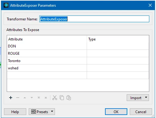

I know there is the AttributeCreator
but the created attributes need an AttributeExposer to make them visible in folowing transformer or writers.
Since I don’t know all the possible values like apple, donut, … in advance, or there migth be too much, I’m stuck...

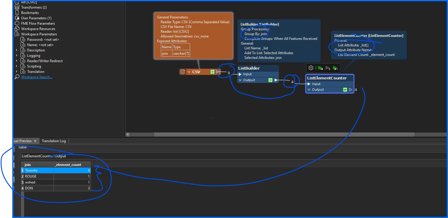

Hi ​@ziur You could skip the histogramer by Grouping the list on the attribute then using the ListElementCounter
Hope that helps!

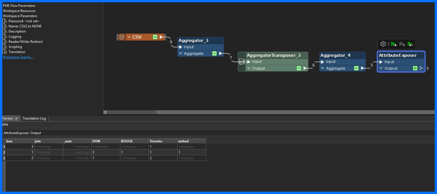

Okay I think I got a version working. Using 2 aggregators we get to a table with box as rows and attributes as columns. Not perfect but I hope it gets you going in the right direction.
ziur

the result looks as desired. one point is still not resolved: you typed in the attribute names in the AttributeExposer:
Any chance to do this dynamically depending on the data?

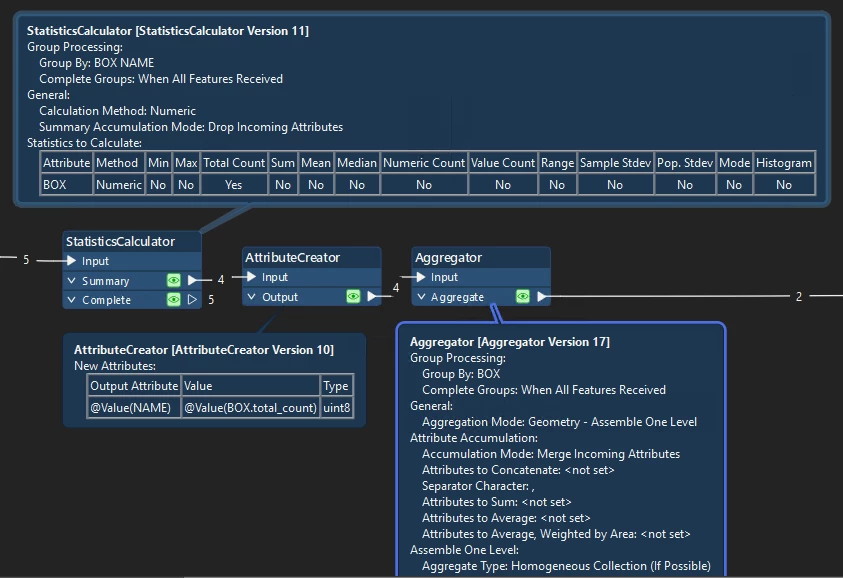

This is how I would transpose your data

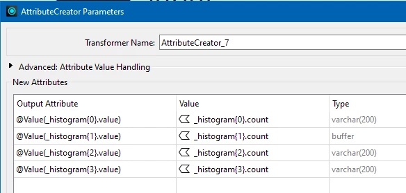

thats true, thank you. I was at this point in my second post of this thread, where I used the AttributeCreator in the same manner as you.
It leaves me with the problems to pass those unexposed attributes to the writer…

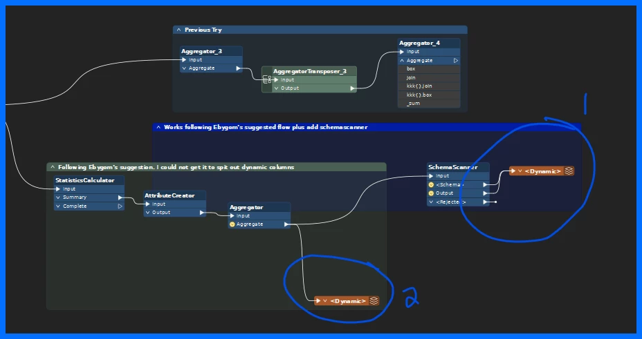

Okay. This one might work. I don’t know why but my brain always melts with exploders and lists and all the fun stuff so I am trying to get better at it. With ​@ebygomm ‘s suggestion I put this one together. Hopefully this works for you. I added a schema scanner b/c I just couldn’t get it to spit out the unexposed attributes no matter how dynamically i danced :D
Hopefully this helps.

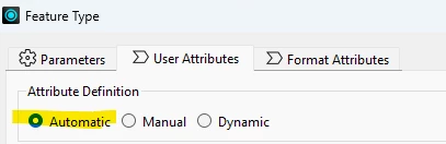

...as soon as they are exposed the workspace is no longer dynamic.
with the automatic Attribute Definition in the writer it would be dynamic enough for me :-)
the attributes wouldn’t have to be defined anywhere in the workspace
but unexposed Attributes are not written…
Anyway with @crutledges example I’m happy. Althoug he says it would not spit out the not exposed attributes - funny enoug it works for me!? :-)
Thanks both of you for your thoughts and ideas!

Glad it got you working ​@ziur . Did the attributes come out for you using the #2 writer (below)? i.e. you did not have to use the schemascanner? Just curious. Always learning.
ziur
Forum|alt.badge.img+16
  • Aug 20, 2025 1:49 PM UTC
​@crutledge Yes, number 2 is good. I suppose it is your writer with the option <@value...>
this produces the columns wanted - among others I happily ignored.
