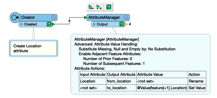

Hi @ae_jeff,
Is the to location always the feature in the row below? If so add an AttributeManager or Creator and under the Advance headed check the 'Enable Adjacent Feature Attributes' box. Set the Number of Subsequent Features to 1 and then you can use this to create the new attribute, see image below:

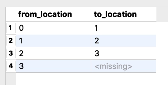

Output:

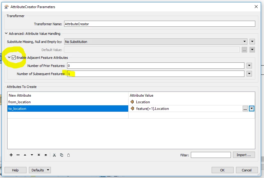

After reading you can do this using the AttributeCreator with the following settings:
Works great! Thanks for helping a new FME user, @erik_jan!
