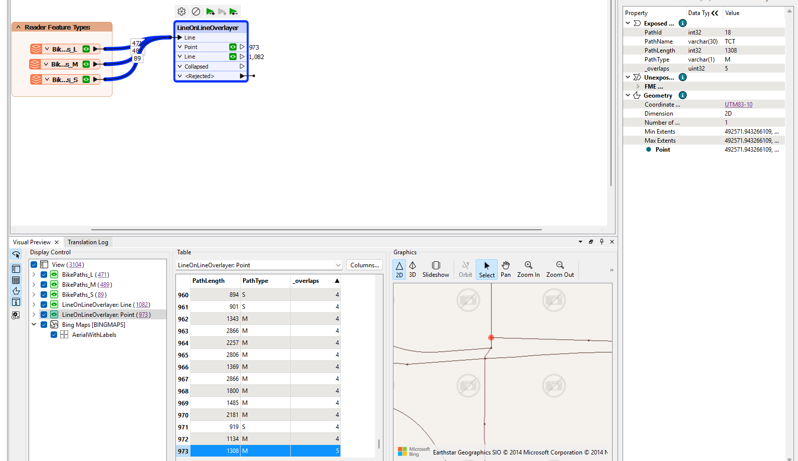

​@robinb
Have you explored looking at the _overlaps value of the point features coming out of the “Point” output port of the LineOnLineOverlayer?
Happy FME:-) ing

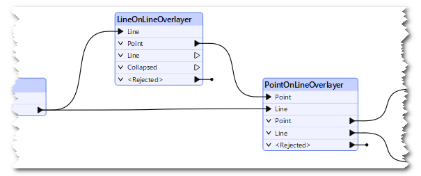

takashi
  • May 8, 2025 2:12 PM UTC
Hi ​@robinb ,
LineOnLineOverlayer split input lines at their intersections including self-intersections, but self-intersection points won't be output from the Point port. So, I think you can get required result by using the points output from the Point port of LineOnLineOverlayer to split the original lines again with PointOnLineOverlayer. The data flow looks like this.
Split Lines at Intersections excluding Self-Intersections
