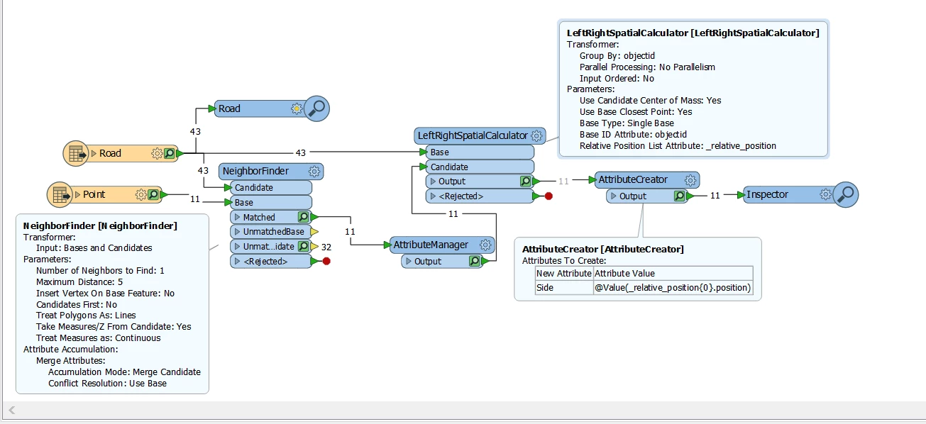

Hello
I am using the left-right transformer in order to see the location of the point compared to the road, but it's not giving the expected value, all output is in right but visually are not
I reproject both inputs to the same CS but still the same result
Any idea?
  • Jan 24, 2019 9:39 AM UTC
Left and right consider the direction of the line. Your points are always to the right of the line as you have paired lines drawn in opposite directions. The point is always to the right of the closest line when you consider the direction of that line.

@egomm
Thanks for your help how could we get the direction of the line
redgeographics
VIP
Forum|alt.badge.img+63
@egomm
Try the AzimuthCalculator
