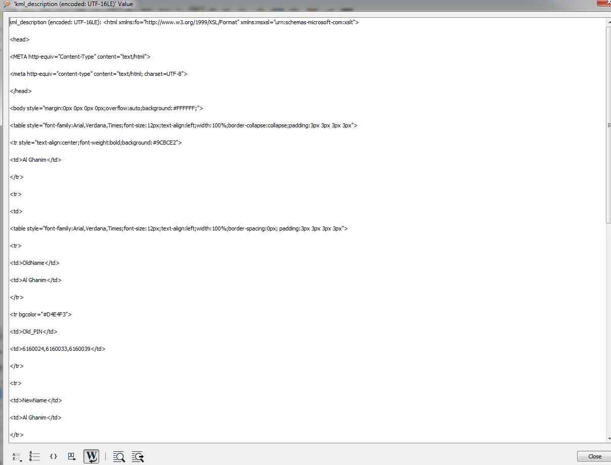

i dont know how do it, i see some discussion here but i dont know what i do wrong.
the input
the worckbench
daveatsafe
Forum|alt.badge.img+24
  • Dec 18, 2018 11:49 PM UTC
Hi @ftl,
Please change the XQuery expression in the XMLXQueryExtractor to:
declare namespace x='http://www.w3.org/1999/xhtml';
for $x in /x:html/x:body/x:table/x:tr/x:td/x:table/x:tr
return fme:set-attribute($x/x:td[1]/text(),$x/x:td[2]/text())

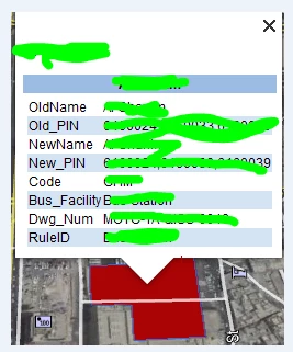

Bare in mind this works beatifully if the kml_description is displayed as a table. It could be modified to present the data with a custom layout that drops the table settings. In those cases, extracting the attributes is way trickier.
