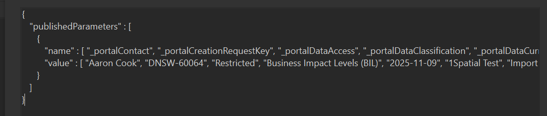

I need to output a list of paired values as a JSON File.
I have a list called JSONList with two attributes JSONname and JSONvalue.
I am using the JSONTemplater to organise the data.
I have the root template set as
  "publishedParameters": [
    fme:process-features("SUB")
and the SUB Template as
  "name": fme:get-list-attribute("JSONList{}.JSONname"),
  "value": fme:get-list-attribute("JSONList{}.JSONvalue")
but I am just getting the name and value as a single line each.
How do I change the structure so each name and value pair are separated, similar to the below?
      "name": "_portalLayer",
      "value": "parks"
      "name": "_portalOrganisation",
      "value": "SWR"

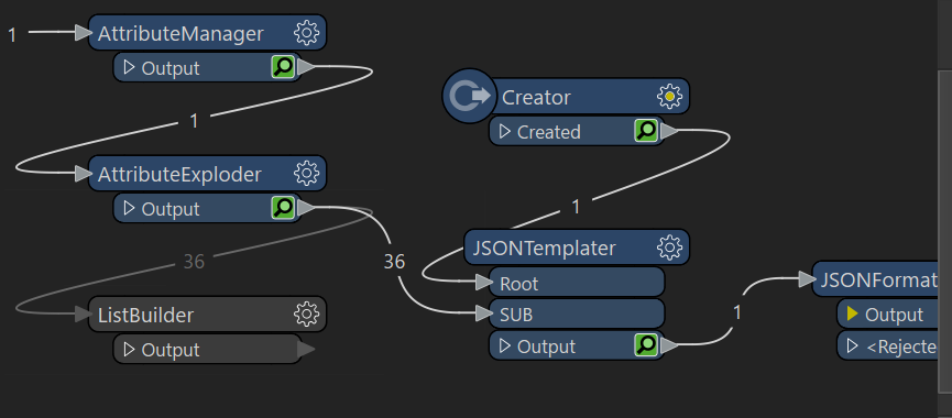

Best answer by takashi
Hi ​@deanhowell ,
A simple way is to extract elements of the JSONList{} with ListExploder beforehand, then set this expression as the SUB template in the JSONTemplator.
"name": fme:get-attribute("JSONname"),
"value": fme:get-attribute("JSONvalue")

deanhowell
Forum|alt.badge.img+24
  • May 5, 2025 10:13 PM UTC
Thanks ​@takashi great advice as always. I was just over complicating things and had a list builder in the process, which wasn’t needed.
