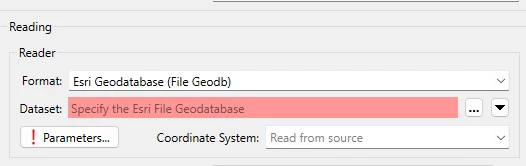

When reading Esri Geodatabase formats, you can click on the Parameters button and there is an option to Resolve Domains.
Note, you will need to be using the Esri File Geodatabase format, not the open API format.
As per the documentation,
Specifies whether or not to resolve the domain code found in feature classes and tables into the domain value.
This means that when an attribute of a feature has a coded value domain associated with it, another attribute will also be added that represents the textual description of the coded attribute. The new attribute will be <attribute-name>_resolved, where <attribute-name> is the name of the attribute containing the code.

  • Oct 6, 2025 1:14 PM UTC
