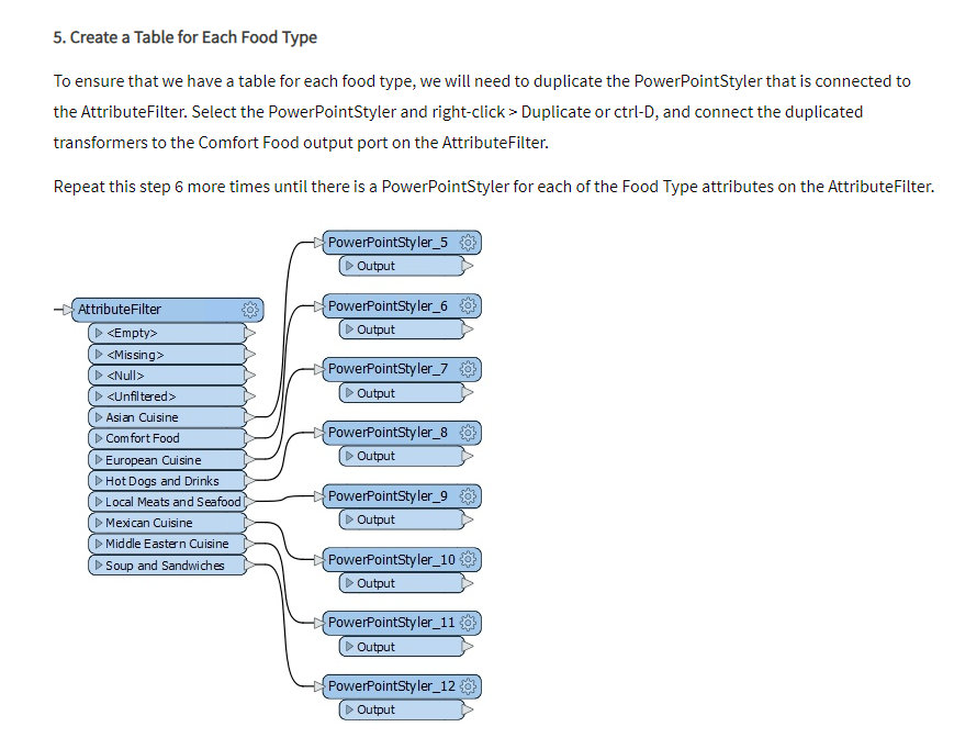

It's in step 3 that I run into issues. I can't find a way to dynamically filter attributes so that I can write to separate slides like I see in the tutorial. The attribute names aren't fixed, so the Attribute Filter doesn't work, at least not that I can see so far. https://community.safe.com/s/article/getting-started-with-the-powerpoint-writer-tables

I found a really nasty way to do this. I add a counter to the front, and this allows me to group by count. Because the numbers are always going to be the same, I can use the attribute filter and handle any amount up to 40. Not at all elegant. But it will do up to 40 submitted records at a time. to add more 'capacity', just add more attribute filters and PPT stylers. I hope someone sees this and tells me there's an easier way. But for now, I will be content with 201 PowerPointStylers in my workbench.
