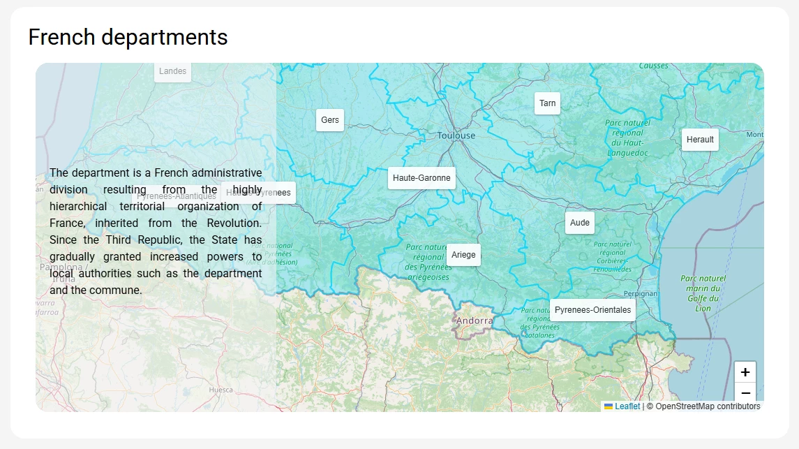

Hi ​@alexbiz,
this is so great - thanks! I am already in the process of creating a HTML report, thats going to blow my customers mind :D
Just wanted to ask, since I am not a programmer, if there is an easy way to make “Label Attribute” in the BRGMap available, as it is in the HTMLReportGenerator?
Or could you recommend an easy workaround?
Thanks and best regards,
Johanna
alexbiz
Forum|alt.badge.img+35
  • Aug 1, 2025 9:00 AM UTC
Hey ​@johannafalk1, thank you for your enthusiasm !
You’re right. It’s not possible as of now with BRGMap. But that’s a good suggestion. I’ll update it to add that feature.
Maybe there’s even more options we could give to it ? Like, should the labels be always displayed, or only after selection/being clicked ?

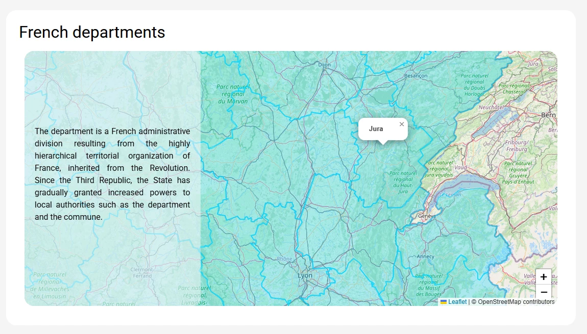

Hi ​@alexbiz,
thank you so much!
In my opinion it would be great if there was a parameter that you can select, if you want to show labels or not. And then only make them visible when the user clicks on the geometry.
Best regards from Vienna,
Johanna
alexbiz
  • Aug 4, 2025 9:36 AM UTC
Hey Johanna ! ​@johannafalk1
I’ve just updated the BRGMap transformer. You’ll find two new parameters :
Display On Click
Always Display

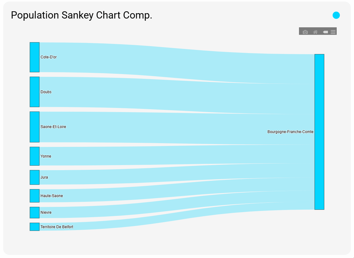

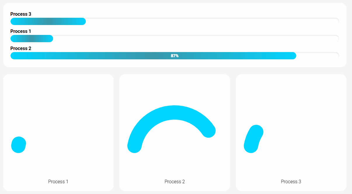

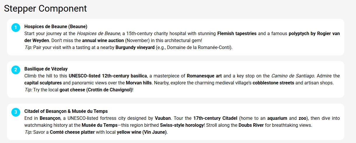

BRGStepper
BRGProgressBar
BRGSankey
These are just proof-of-concepts to explore what’s possible, so they might not end up on the FME Hub.
That said, if you have ideas for new components or any feedback, I’d love to hear them!

The BRGMap transformer generates a script that uses the standard ‘pin marker’ to display points, whereas ideally I would like to have circle markers for my map which change size based off a separate attribute. Would this be possible to achieve with your transformer set?
Thanks,
Matt.
alexbiz
  • Jul 27, 2026 1:47 PM UTC
Hey ​@matt_miso !
Thanks for the support!
Wouldn't using a Bufferer before the BRGMap do the trick?
matt_miso
Forum|alt.badge.img+12
  • Jul 27, 2026 2:55 PM UTC
​@alexbiz - This would change the output to polygons, unless I misunderstand? I would still want the output to be points displayed on the HTML map, but with a dynamic symbol that changes size based off a parameter.
alexbiz
  • Jul 29, 2026 9:12 AM UTC
Hm I see. I might add customization settings for points, lines, and polygons. I could then add a `circleMarker` for points, based on an attribute value.

​@alexbiz - Just to add onto my previous point from a few weeks ago, I’ve been testing your BRG transformers in a few of our products to see if we can make use of them anywhere. One of the issues I have been running into again is styling the map outputs.
For one project, I have 4 or 5 polygons being fed into a BRGMap for display in the end report. These polygons use a label that shows an attribute. This attribute can be 1 - Very Low up to 5 - Very high. However, with the BRGMap transformer I can only display these polygons with the exact same colour, e.g. instead of with a Red/Amber/Green colour scheme.
Do you have any advice on how to modify your output script to incorporate this design? Or is this something you would be able to add to directly to the transformer?
