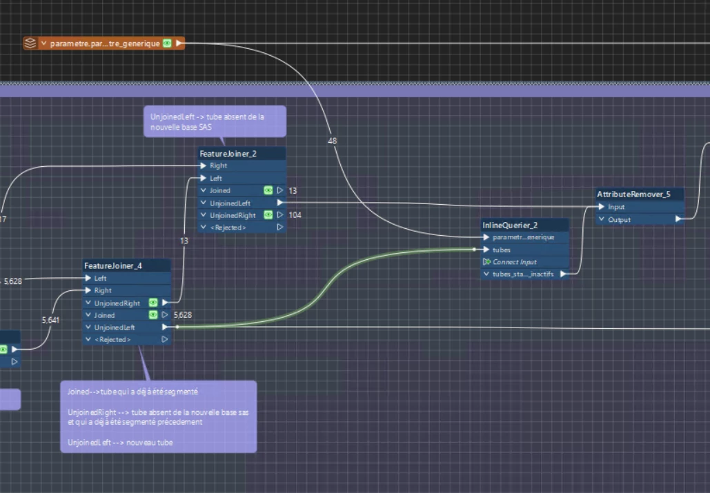

The InlineQuerier has two input ports:
tubes (can sometimes receive no features)
parametre_generique (always receives data)

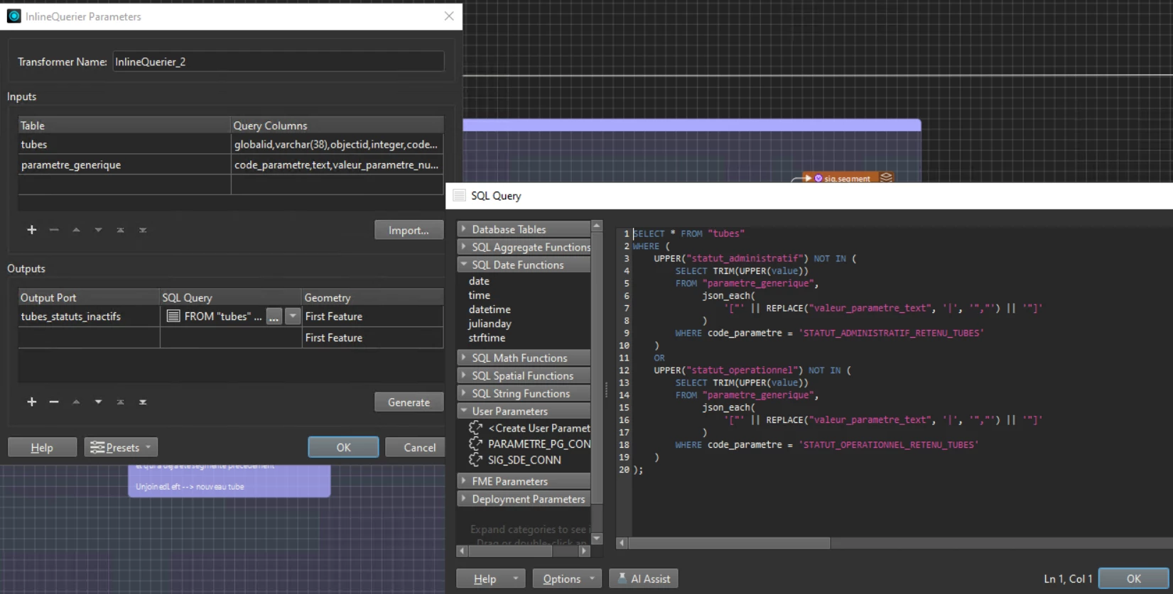

I’m using this request :

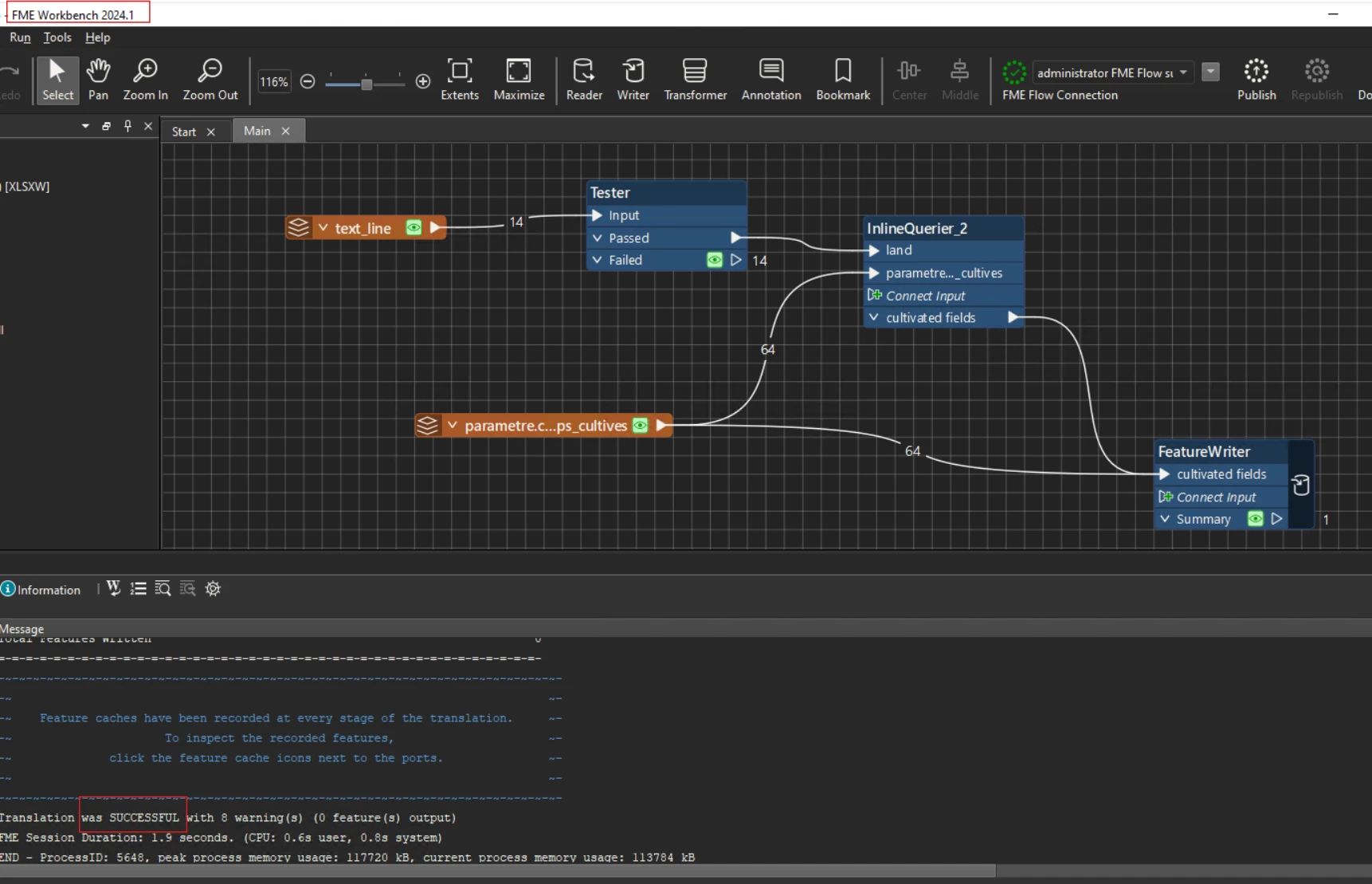

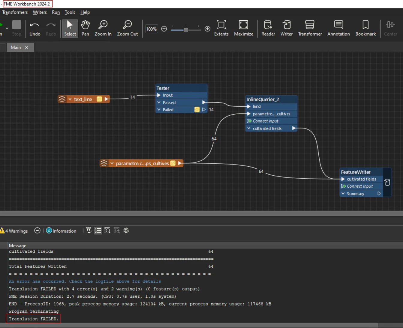

Hi ​@desiree_at_safeΒ Thanks for your Answer,Β
This is a similar workspace sample in both versions :
Β
Β
It’s true that data will still be written even in the second case, but the translation fails just after ): and in my original workspace (witch is way larger)Β this causes job failure mid translation and doesn’t pass other transformers properly !

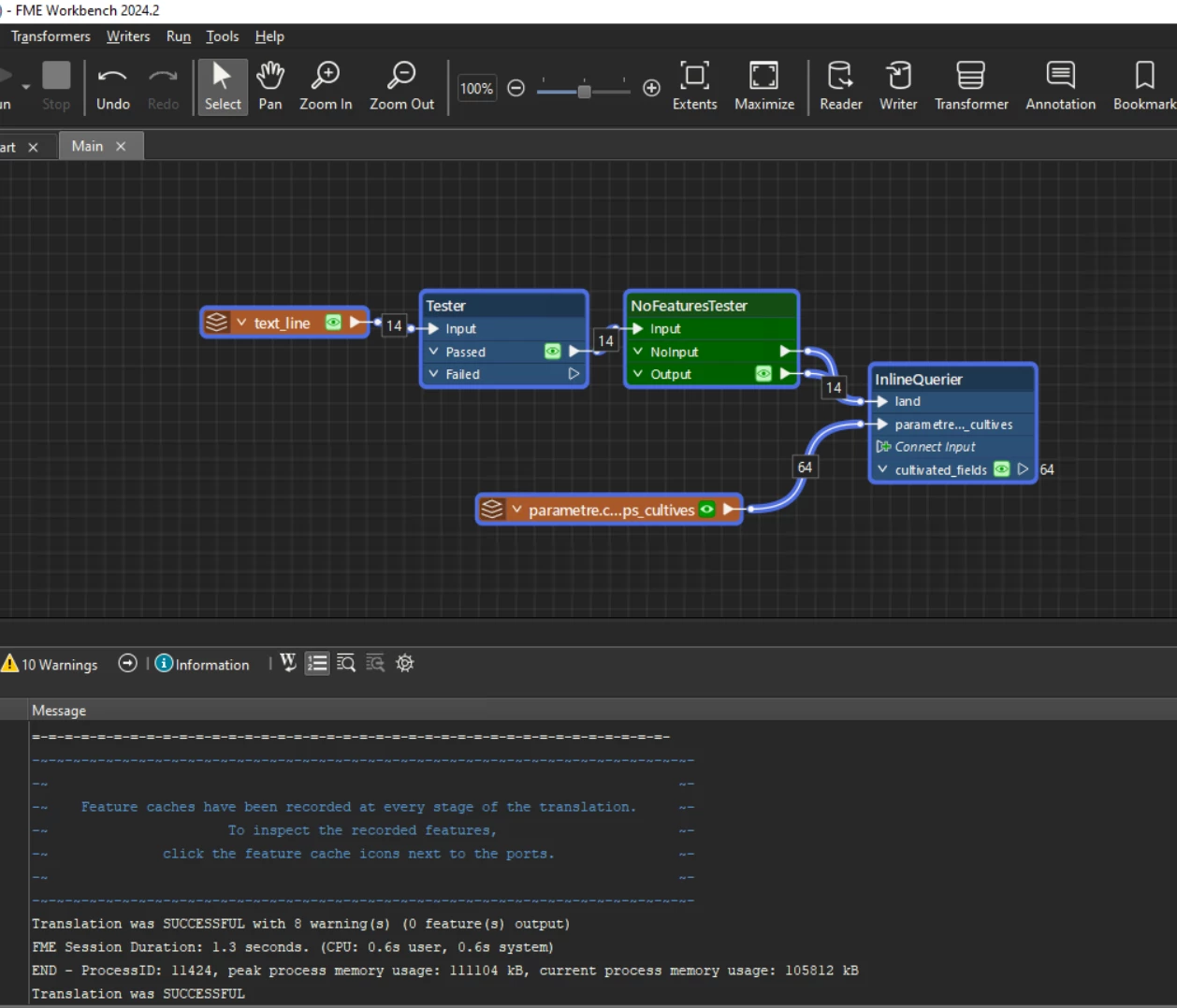

I was able to get my workspace running successfully on FME 2024.2.1 using the NoFeaturesTester, as suggested, as a workaround.
I’ve included a screenshot of a sample workspace showing how it works in both scenarios: when data arrives at the port and when it does not.
Best, sbnikkouΒ
