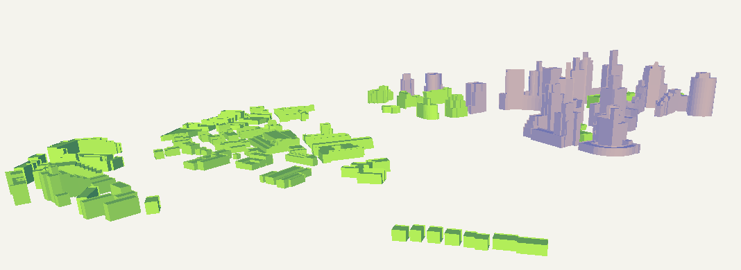

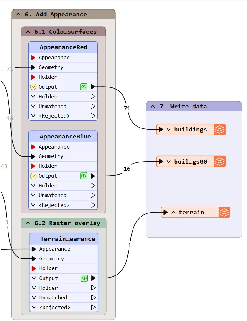

In the exercise: "Add Appearances to a 3D City Model" I have a problem with the "AppearanceSetter" transformer because I cannot get the colors in the buildings in the PDF output, as described by Liz Sanderson. I always get them in RED in both cases, namely: "AppearancesRed" and "AppearancesBlue". I have run the workspace as I downloaded it but both types of buildings always come out in RED in the PDF.

Faltaba un “writer” !

Hello ​@miguelhacar, so sorry for not reaching out sooner, were you able to apply appearances? I think we need to update the ‘Geometry XQuery’ in the AppearanceSetters to use Interior Nodes, opposed to Root Nodes. I’ve attached a workspace as an example. Let me know if you have any questions. Happy to help, Kailin.
