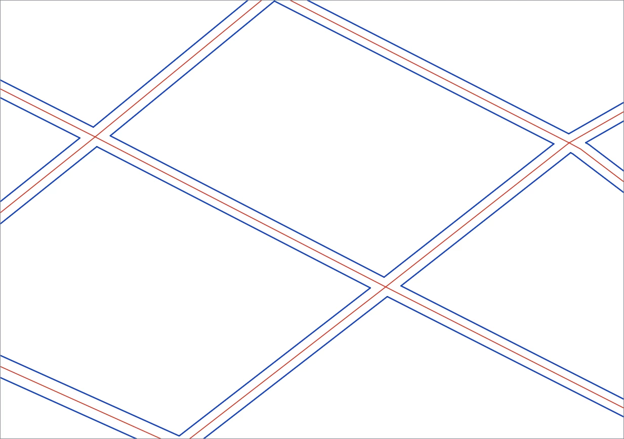

Hi all,
I have a dataset which represents the street curbside. Relative to centerline dataset, I am aiming to identfying the position of curb side (e.g. left right) I have used LeftRightSpatialCalculator to accomplish it. However, all the lines are getting Left as a relative position.
In the attachment, you can find the input data as well as my transformer.
Thanks in advance.

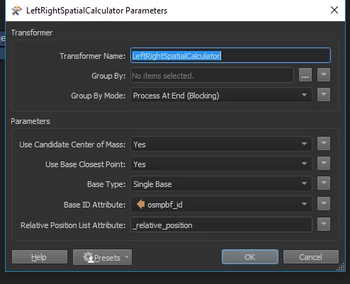

  • May 29, 2019 1:59 PM UTC
Which lines are you setting as base and which as candidate?
jdh
Forum|alt.badge.img+41
  • May 29, 2019 3:26 PM UTC
You have it set to single base, but you have many centerline features.
jugoslaviaa
Forum|alt.badge.img+6
  • May 29, 2019 3:45 PM UTC
I have set the centerline as base and street curbside as candidate.
jdh
  • May 29, 2019 6:17 PM UTC
Attached is a sample workspace that determines sideness of curb features to the nearest centerline. This can be simplified if there is attribution linking the two sets of features.
