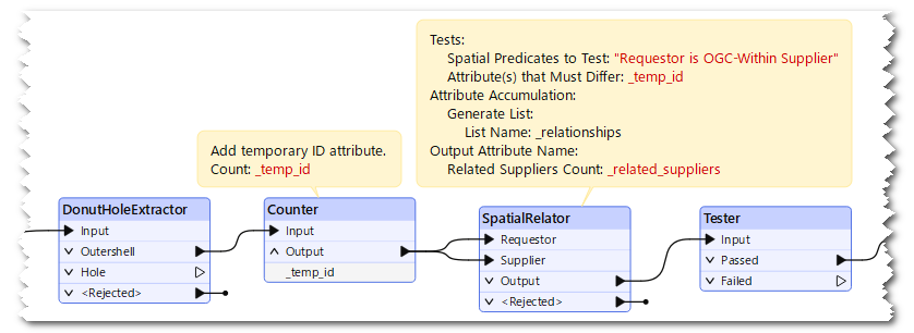

If you would like to detect "island in lake in island", I think a combination of DonutHoleExtractor and SpatialRelator works fine.
  1. DonutHoleExtractor : Extarct outer shell polygons.
  2. Counter : Add a sequential number attribute to the outer shell polygons as a temporary ID, if the source features didn't have unique ID attribute.
  3. SpatialRelator : Send all the outer shell polygons to both Requestor port and Supplier port, and set these parameters.
    • Spatial Predicates to Test: "Requestor is OGC-Within Supplier"
    • Attribute(s) that Must Differ: <the ID attribute>
The resuling features will have an attribute (named "_related_suppliers" by default) which stores the number of outer islands, and the number will be 1 or more if the feature was an "island in lake in island".
