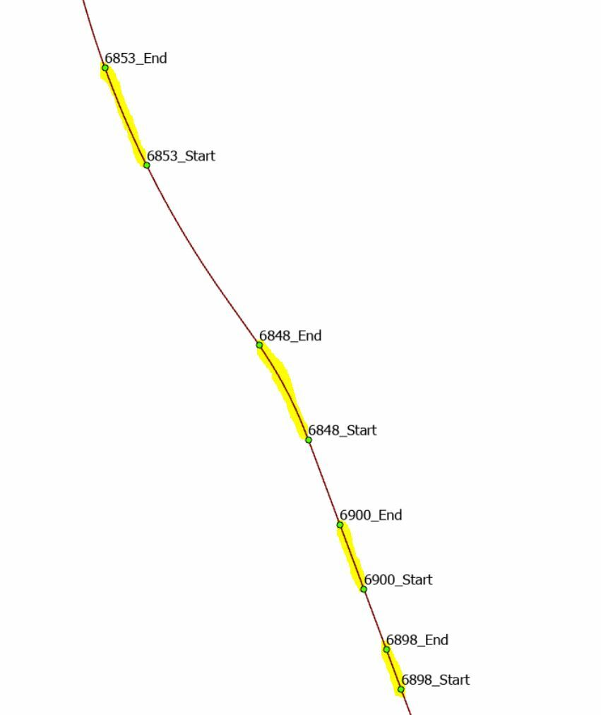

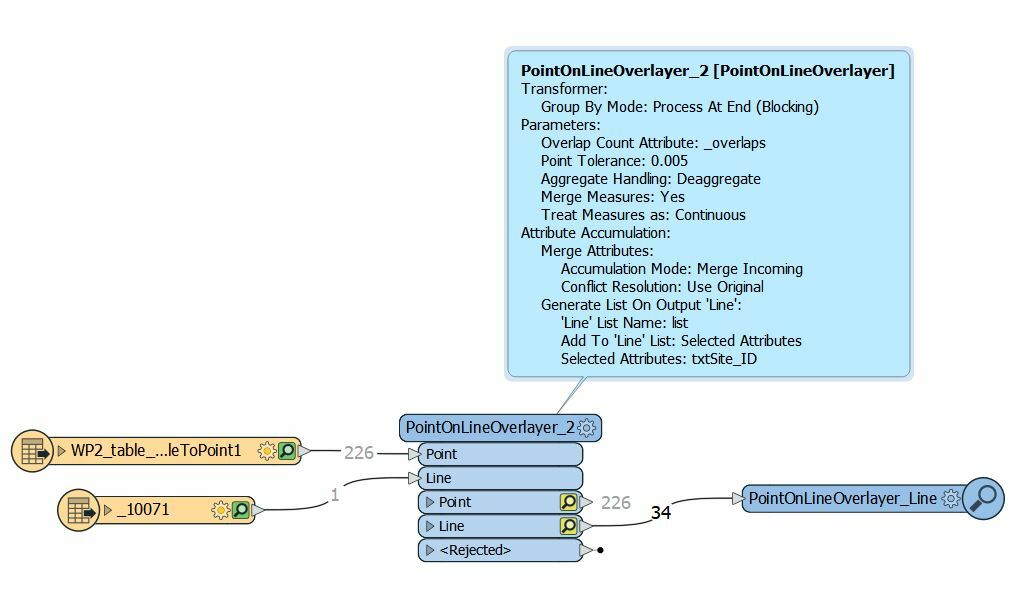

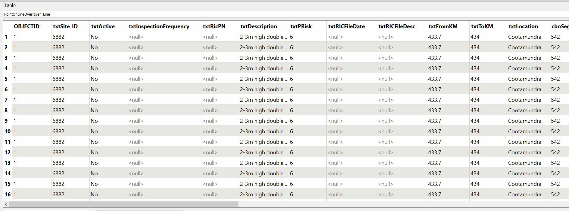

I have a line file (1 line) and a point file (Multiple pairs of start/end points). I'm trying to clip multiple line segments from a single line based on a start and end points with matching ID attribute. I have been trying PointOnLineOverlayer but it adds the attributes from only the first point to every line. When I generate a list based on the ID the list includes every point ID on every line, not just the points that the new line intersects.

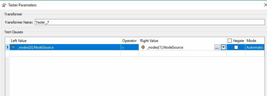

To find split lines that have the same Start and Stop Group ID is just then using a Tester on the Edges ouput port from TopologyBuilder: Where _Nodes{0}.GroupID = _Nodes{1].GroupID (assuming there should only be ever 2 Nodes per Edge),
