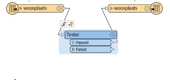

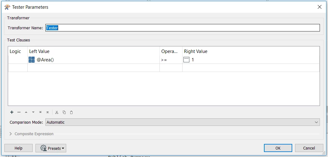

Hi, what are you using, a database table and delete the items in it that are too big? It might need a different setup.
If you just want a file without areas that are, say, less than 1 sq m you could indeed use a tester:
After that you connect the passed port of the tester to the input port of the writer, you will end up with a file having only area's larger than 1 sq m (if that is the coordinate system you are working in). Leave the Failed port for what it is, like:
