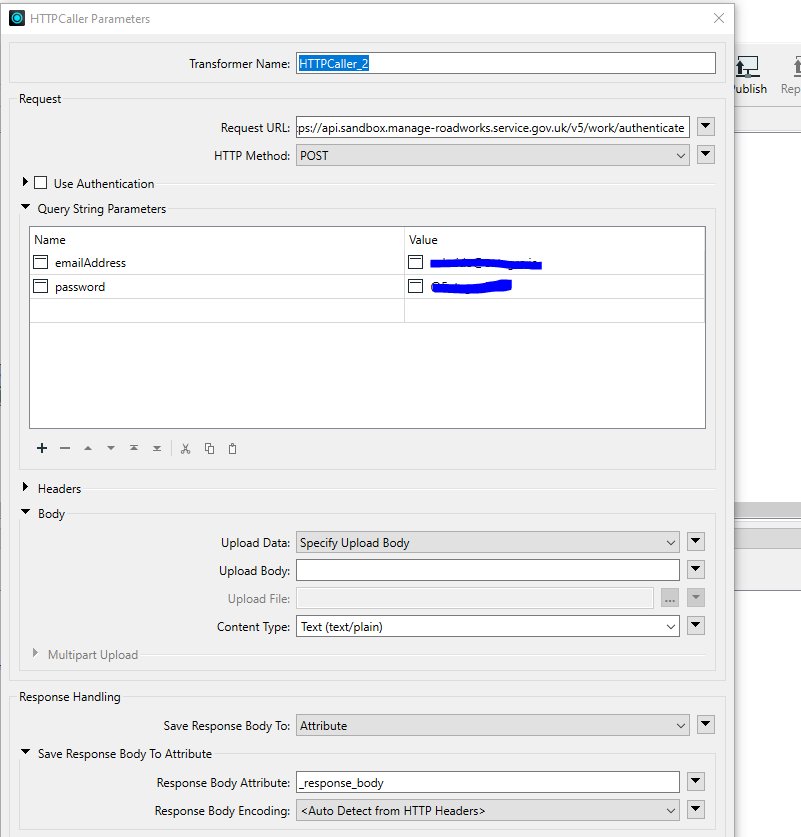

  • Nov 22, 2024 10:02 AM UTC
Using HTTP Caller

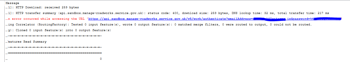

FME Error

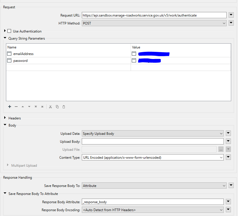

Content Type is set to text. Please try and switch that to
URL Encoded (application/x-www-form-urlencoded)
elmido13
Forum|alt.badge.img+4
  • Nov 22, 2024 10:31 AM UTC
​@nielsgerrits Thank you for your response.
Still getting this error below
{"message":"","error":{"fields":{"body.emailAddress":{"message":"'emailAddress' is required"},"body.password":{"message":"'password' is required"}},"status":400,"name":"ValidateError","x-request-id":"kcgXSuAoin2FBs4hVrioNOfk48s5crl0s6IIb-SDMZjCsKZXWhBawg=="}}
