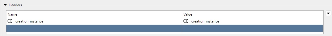

In the headers section, it seems it’s mandatory to define the header parameter immediately.
Is there any way to push a Json or a FME attribute to define a dynamic header to use?
My issue is, the client API Rest has many methods with different header parameter. I’m trying to setup a custom transformer that will be able to handle dynamically the header to set. But it doesn’t seem possible to do it right now?
Any workaround to achieve it?
Regards,
Jean

You can dynamically set a defined number of parameters by using attribute values
But I agree that you can’t set them ‘dynamically’.
I think this would be worth submitting an idea for - https://community.safe.com/ideas
Something similar to how a schema feature contains a list of the schema. You could have a list that contains each of the headers - similar to how the Requests Module in Python works with a dictionary

Hi ​@hkingsbury, exactly. That would be awesome to prepare all the headers in JSON format to use during the HTTPCaller.
