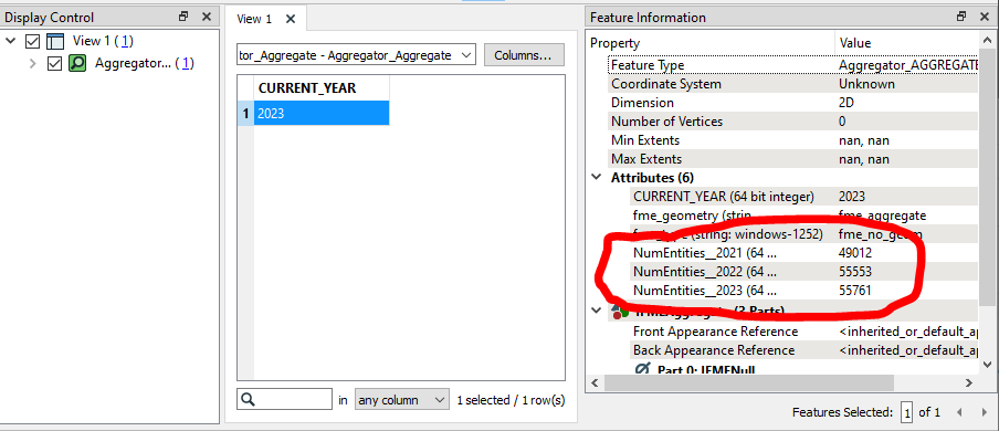

Hi All,
I'm trying to create and write dynamic attribute name with the joined workspace.
In a FFS file, I have C-SEGMT entities. I would like to count how any entities I have until the current year (e.g. 2023) but also for the two previous years (e.g. 2022 and 2021) and put the result in a dynamic attribute name (for my example, three attributes named "NumEntities__2023", "NumEntities__2022" and "NumEntities__2021"
I can create them, as you can see it in my Workbench and the screen capture, but I don't know how to write them in my Writer. It's OK for a FFS Writer, but if I want to write in a GEOJson file or other formats, it fails.
I could name them directly "NumEntities__2023", "NumEntities__2022", "NumEntities__2021" ; or I could expose them with AttributeExposer : I can see their name if I have enabled feature caching. But my goal is, if I run the workbench next year, the attributes will be automatically renamed "NumEntities__2024", "NumEntities__2023", "NumEntities__2022".
Does anyone has any idea ? The attributes must be in the same file and same FeatureType, so I can't use the fanout option (but maybe I have used it wrong). Published Parameter ?
Many thanks !
Have a good day
Best answer by nielsgerrits
Please check Tutorial: Dynamic Workflows and more specific Dynamic Workflows: Destination Schema is Derived from a Schema Feature
I think I would use the SchemaScanner to create a Schema Feature and use that to write the schema dynamic as data defines it.
Forum|alt.badge.img
  • Jan 20, 2023 3:28 PM UTC
Hi Niels,
It perfectly works ! The tutorial is clear enough to get what I want.
Many thanks
