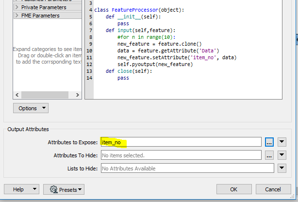

  • October 9, 2019
Have you exposed the item_no attribute?
Forum|alt.badge.img
  • October 9, 2019
