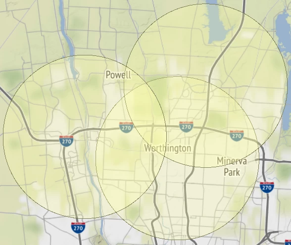

Hi everyone,
This is what I have currently:

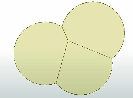

And this is what I want:

Best answer by ebygomm
I would use a VoronoiDiagrammer for this, get centrepoints from the circles (or maybe you have them to start) then send into a VoronoiDiagrammer setting the radial limit to whatever size your circles should be
