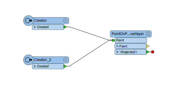

Im trying to solve problem with analysis. I need to proceed analysis only in situation when features came from both inputs. If features will come only from one input, analysis will not be processed.
E.g. attached pic below
I want to process PointonPointoverlayer analysis only in situation when features will come from Creator and Creator_2. In situation when Creator or Creator_2 output no features, overlay analysis will not be processed.
Do You have any idea how to solve this issue please?
Thank You so much!
Lubo
Best answer by jdh
Put a NoFeatureTester on each of the Readers, and connect the NoInputs ports to a Terminator, and the Input to your PointOnPointOverlayer.
jdh

Hello @jdh,
good idea :-) Finally, I solved problem through attribut creator and feature merger, because problem was more complexive :-) But thank You so much!
