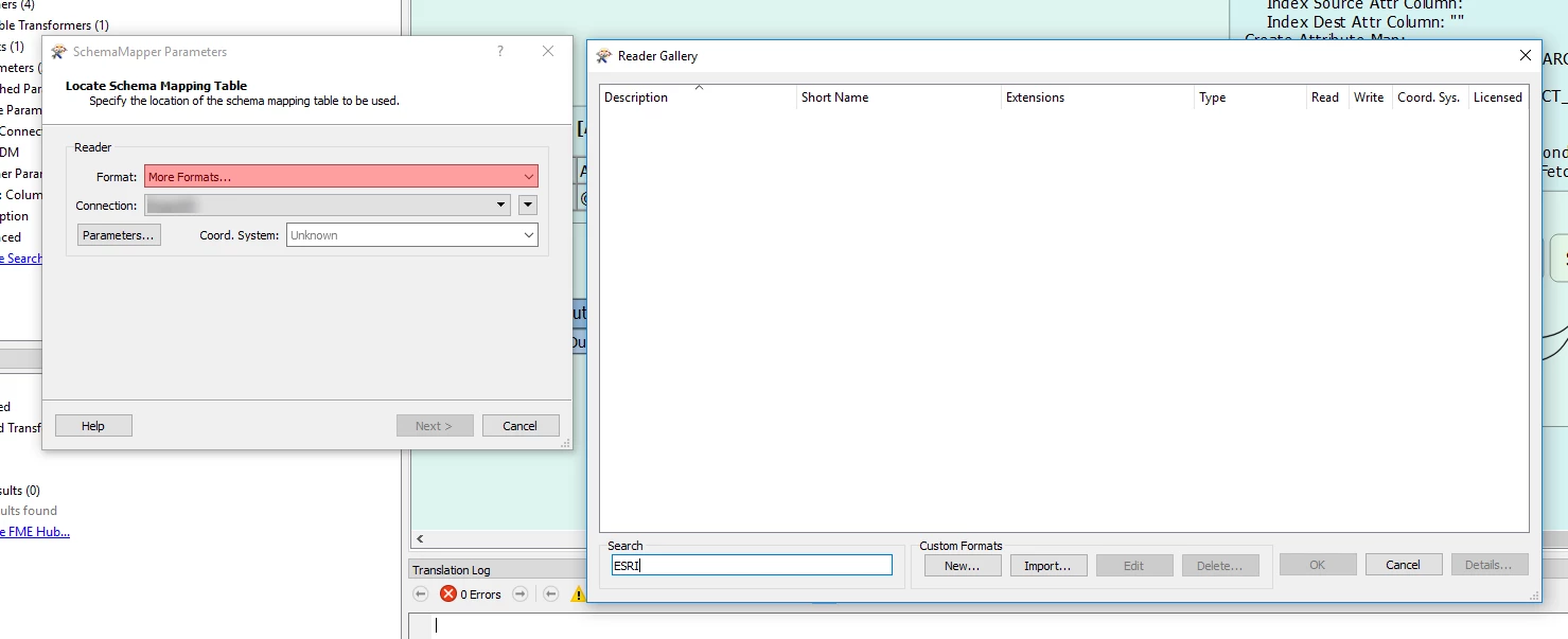

Currently I have a schema mapping table stored on a ESRI Geodatabse table. Trying to use the SchemaMapper I found that the reader does not allow me to select the ESRI readers:
I tried to create a custom reader that connect to the ESRI Geodatabase, but the SchemaMapper does not recognize my custom reader neither.
what should I do in order to be able to extract the schema mapping table for the SchemaMapper from the geodatabase?, or how to enable the custom reader?
thanks

I tried it by selecting the Generic format in the SchemaMapper and then selecting a File Geodatabase, specifying the format in the Generic reader parameters. However, it looks like all columns except ObjectID are empty that way, so it's not useful... (I did doublecheck and read the same geodatabase through a regular generic reader and that did work fine).
I don't have ESRI software on this machine so I had to use the OpenAPI option, maybe it will work through ArcObjects. If not, I think @itay's suggestion is the best way to do it at the moment, although you may want to create an idea for the SchemaMapper to be able to use features in memory as a source.
