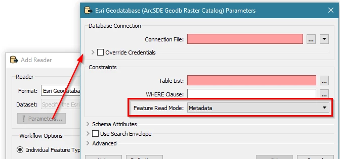

Untested, but I suspect you'll need to read and write the metadata separately:
See also:
https://knowledge.safe.com/articles/22583/working-with-geodatabase-metadata-writing-to-xml.html

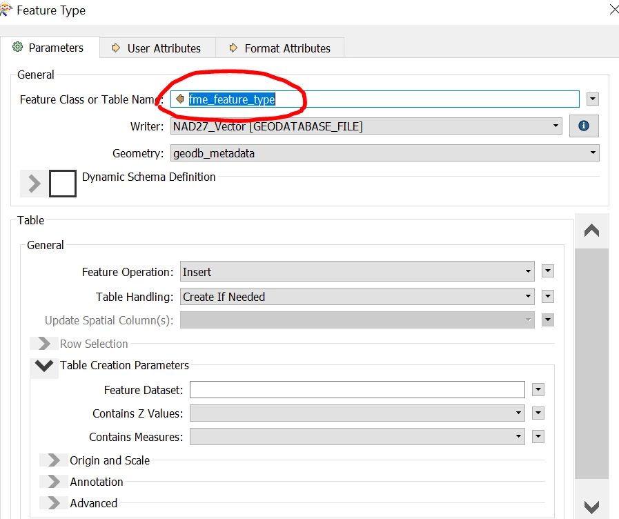

@david_r Thanks, it worked. For reader (Esri Geodatabase (File Geodb)), I used "single merged feature type" to work with many feature classes, in parameters, as per your advice, used "metadata" for feature read mode and then used "geodb_metadata for allowed geometries.
For writer, I used "fme_feature_type" for Feature Class or Table Name.
