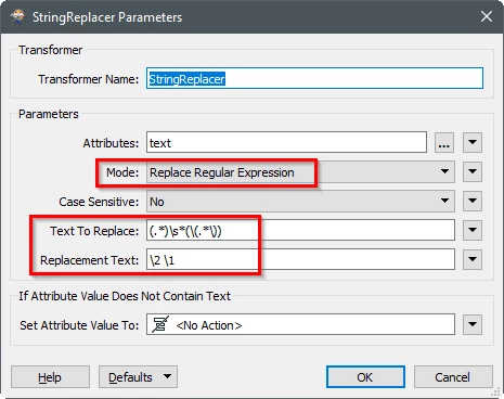

Best answer by david_r
Try the following in a StringReplacer. Text to replace:
(.*)\s*(\(.*\))
Replacement text:
\2 \1
7 replies
david_r
  • Sep 19, 2018 12:24 PM UTC
(.*)\s*(\(.*\))
Replacement text:
\2 \1

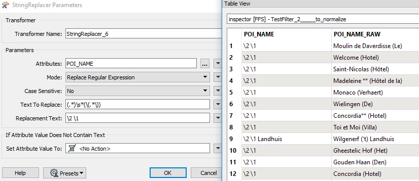

Hi @david_r
I'm getting \2 \1 as a string instead of referring to the capturing groups?

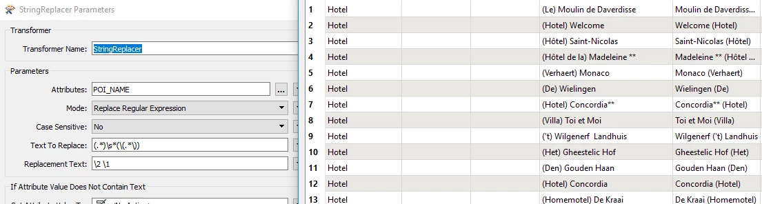

Forum|alt.badge.img
  • Sep 19, 2018 12:49 PM UTC
@david_r
It appears the 2019 beta is the problem!
2018 works:
