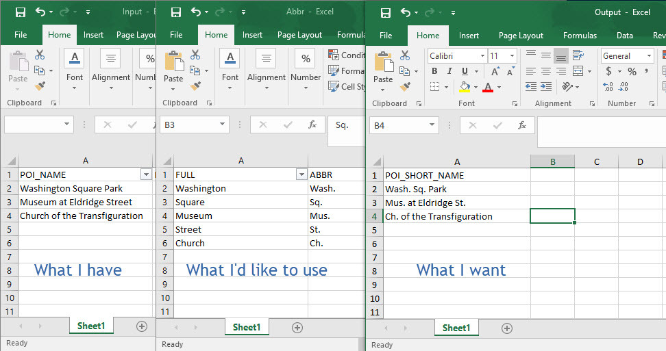

Hi all,
I have a list of POI names that I'd like to abbreviate using an a Excel file that contains the keywords.
I only like to abbreviate the words found in the string that match with the keywords - not the whole string.
Basically what a StringReplacer does, but in bulk.
Thanks,
Eduard

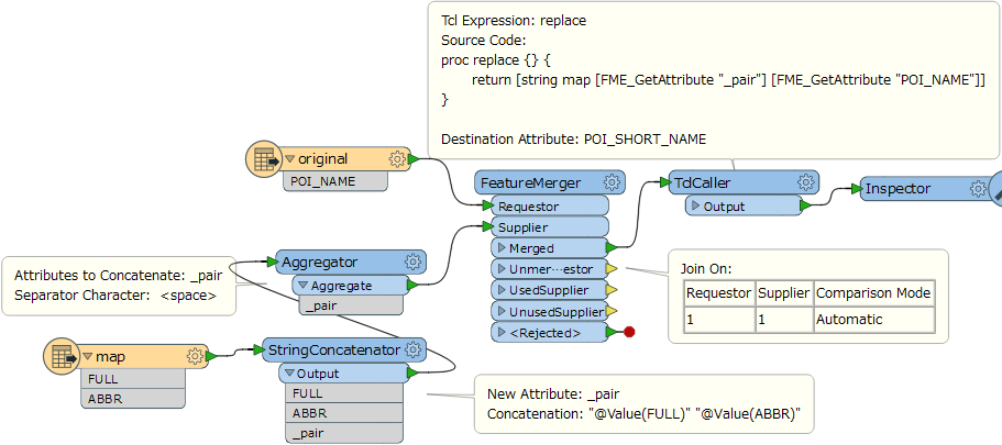

I found two ways.
1. Decompose, replace words if necessary, re-construct the name.
2. Use a Tcl command.
proc replace {} {
    return [string map [FME_GetAttribute "_pair"] [FME_GetAttribute "POI_NAME"]]

I found two ways.
proc replace {} {

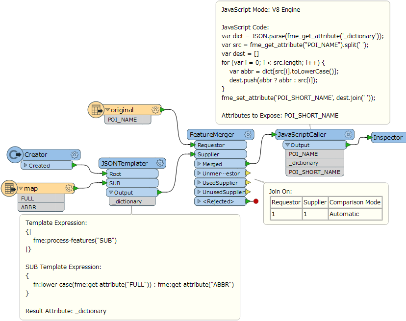

Another way. The JSONTemplater in the workflow below creates a dictionary looks like this, and the JavaScriptCaller creates the short name according to this dictionary.
   "washington" : "Wash.",
   "square" : "Sq.",
   "museum" : "Mus.",
   "street" : "St.",
   "church" : "Ch."
JSONTemplater ROOT Template Expression:
    fme:process-features("SUB")
JSONTemplater SUB Template Expression:
    fn:lower-case(fme:get-attribute("FULL")) : fme:get-attribute("ABBR")
JavaScript Code:
var dict = JSON.parse(fme_get_attribute('_dictionary'));
var src = fme_get_attribute("POI_NAME").split(' ');
var dest = []
for (var i = 0; i < src.length; i++) {
    var abbr = dict[src[i].toLowerCase()];
    dest.push(abbr ? abbr : src[i]);
fme_set_attribute('POI_SHORT_NAME', dest.join(' '));
Forum|alt.badge.img
   "square" : "Sq.",
   "museum" : "Mus.",
   "street" : "St.",
   "church" : "Ch."
JavaScript Code:
var dest = []
This seemed to be good solution for my problem, until I found out that JavaScriptCaller is deprecated. Is there replacement for this JavaScript code?
