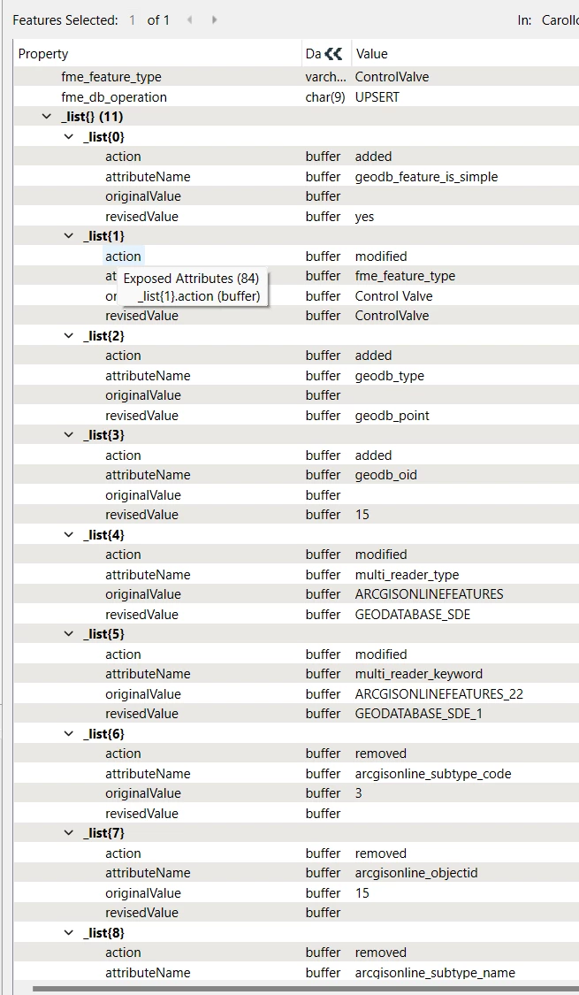

I am trying to use the ChangeDectector to compare datasets before loading. First set is AGOL data, new set is SDE data. Every features is considered “changed” because of unexposed attributes that I don’t want to compare. When I have it set to “compare all except”, I am excluding attributes like “last_edit_user” and “last_edit_date”. There are only 4 to exclude and they are the same 4 for all the datasets so I am able to duplicate the transformer. But all records are exiting the “Updated” port because of these unexposed attributes: geodb_type, multi_reader_type, geodb_oid, etc. I dont want to compare these and I also don’t want to expose them first becuse the AGO layers don’t have some of them so I would have to create them and then exclude them.
Alternatively, I could use “Only compare these attributes”, but because each set of data to compare have different attributes, I would have to fix the ChangeDetector transformer for each set.
Is there a way to discard attributes that are NOT exposed from the comparison?

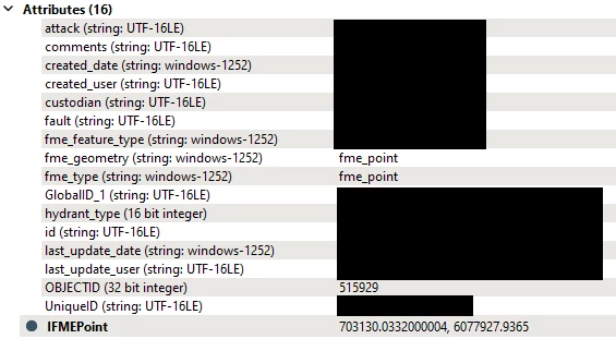

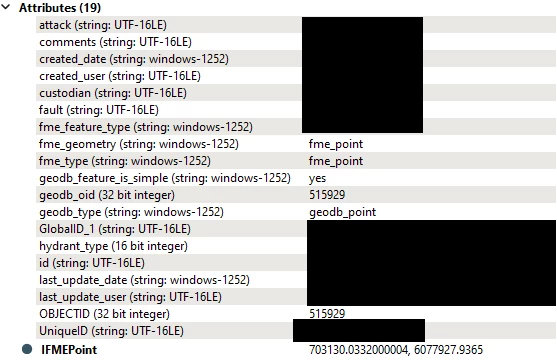

tomf
Supporter
Forum|alt.badge.img+31
  • Supporter
  • Aug 25, 2025 4:03 AM UTC
I use the AttributeKeeper for just this reason and I find it removes most of the FME format attributes, such as those beginning geodb_, multi_, ….
For example, from Reader:
and after AttributeKeeper:
You can see the unexposed format attributes geodb_feature_is_simple, geodb_oid, and geodb_type are removed. This should at least limit the number of fme_ attributes you need to expose/exclude.
