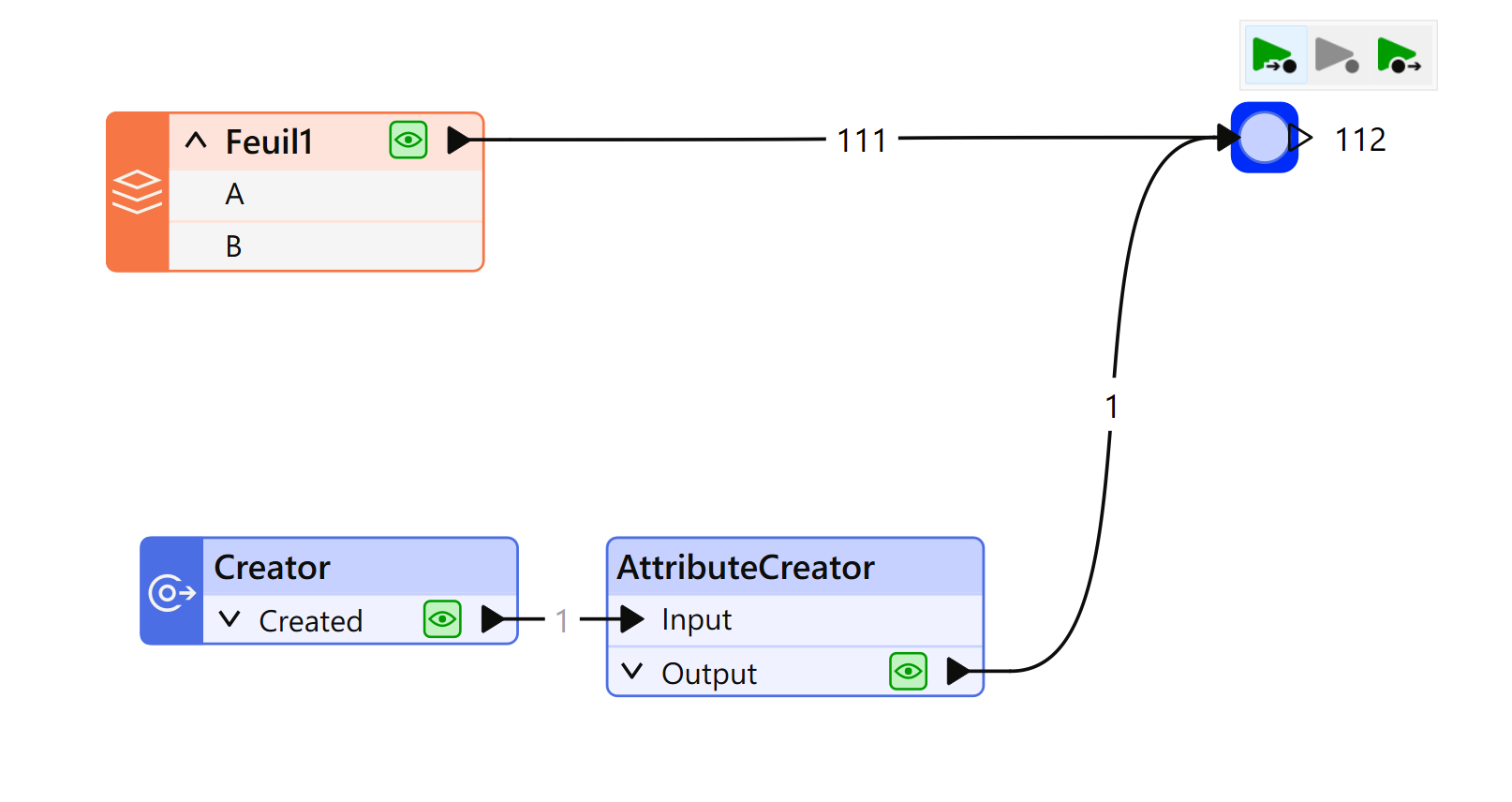

Do you want to create a record in the workspace and then add it to your excel table?
In that case you can use a Creator to create an object and connect it to an AttributeCreator to fill in the information you want and then just connect the streams of your excel table and the newly created object(s).
If you have records from another table you want to join in you can just connect the two streams to one, with a junction for example or just directly into the writer, and the records will be appended into one table.

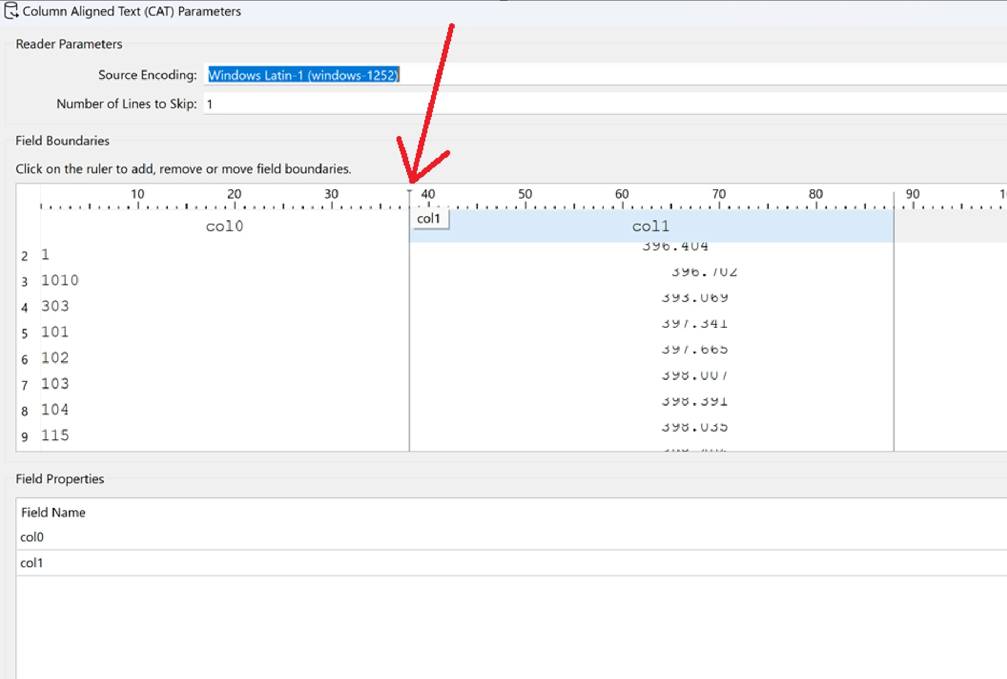

You can try and use a Column-Aligned Text (CAT) Reader when you read in the data. In the parameters you can change the position of the ruler (red arrow) so that it is between the two data columns and it creates 2 different attributes. Then you can manipulate the data however you want and write it out in your desired format.

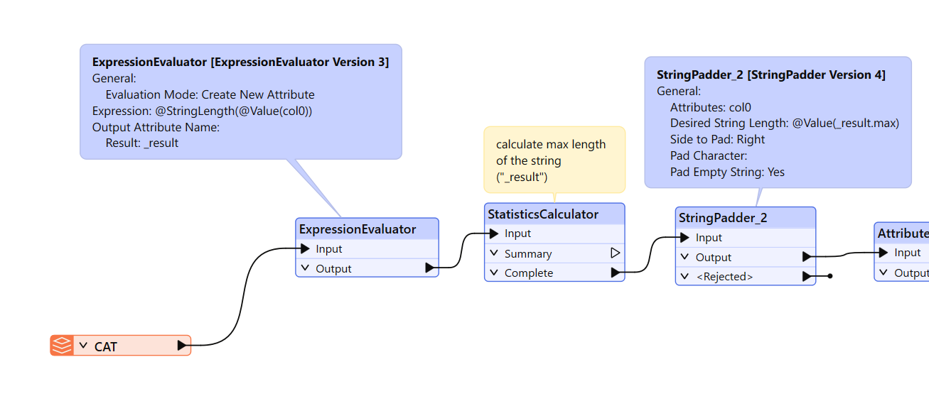

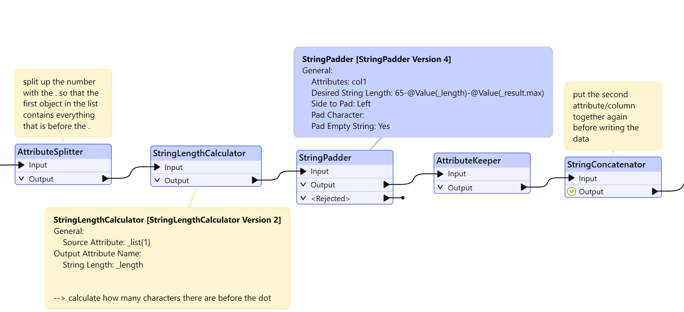

I think it’s because the first “column” has different string lengths so if you pad them into one length it should be easier.
I calculated the max length of the string in the first column and then padded it to that length, so they are all the same length
I then split up the other column that contains the number with the dot (.) to see how many characters there are before the .
From this you can pad this string also so that the . will be the 66th character.
 I’ll attach my workspace so you can try it yourself.
