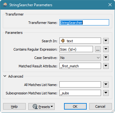

You can also use the following regex:
And specify the subexpression list name "_subs" under Advanced settings:
You will then find the size value under "_subs{0}.part" which you can rename as you wish.
