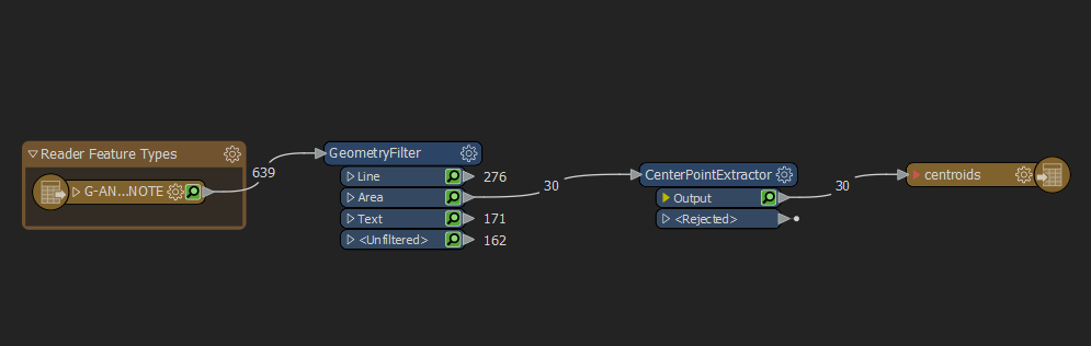

I'm brand new to FME, and I know this is likely a basic question. I am converting a CAD .dgn to ESRI shape files. I want to take the centroids of several cells (polygon features) and export those to shape file. The documentation tells me  x, y, and z attributes are output but I have no idea how to get them to Esri shape file.
http://docs.safe.com/fme/html/FME_Desktop_Documentation/FME_Transformers/Transformers/centerpointextractor.htm
When I put together a workflow, I get no output. What am I doing wrong?

I suggest you use the transformer CenterPointReplacer.

The CenterPointExtractor provides the X,Y and Z coordinates as attributes on the feature. I think you may prefer the CenterPointReplacer, which replaces the input polygon geometry with point geometry of the centroid.

Thanks, the CenterPointReplacer works perfectly. I suspected this was an easy fix but couldn't find the right tool.
