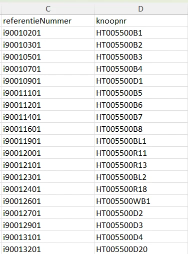

In the column 'knoopnr', each feature consists of a fixed ID (in this example 'HT005500') and a variable ID (B1, B2, BL1, ...). The fixed ID is therefore identical for every row within a project, but it differs from project to project. In another project, for example, the fixed ID could be 'KWL735' for every row. Is it possible to identify the fixed ID and retain only the variable ID?

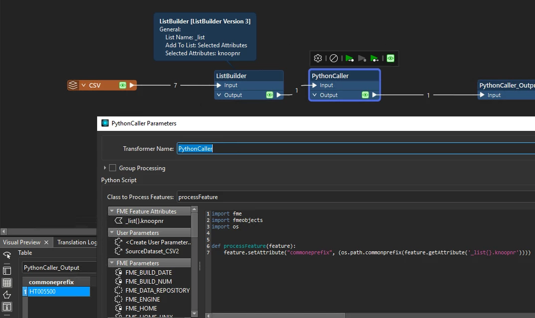

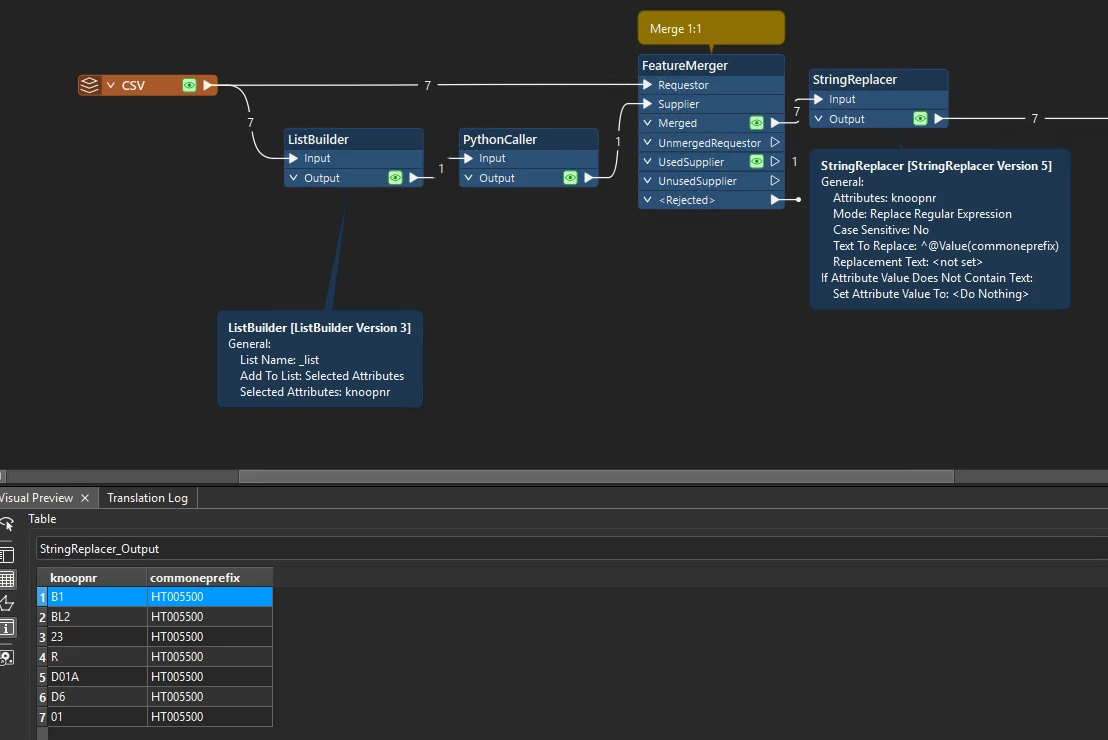

If you don’t mind a bit of python, it’s very easy to get the common prefix using that
Once you’ve got that you can use it in a stringreplacer to remove it and just keep the variable section
(Of course you could do it all in python too)
*It might need a bit of modification to handle cases where the entire value is numeric

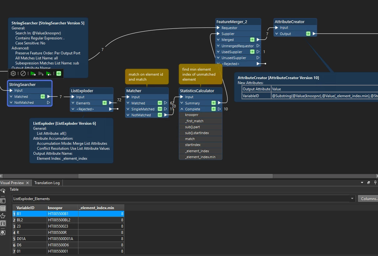

I was curious about a pure FME solution, although i think it would not measure up speed wise to the above
