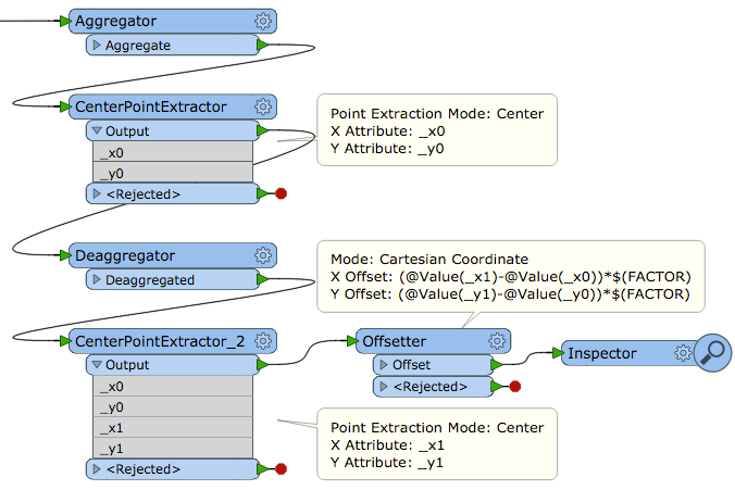

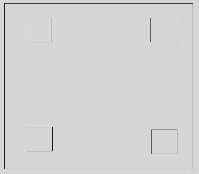

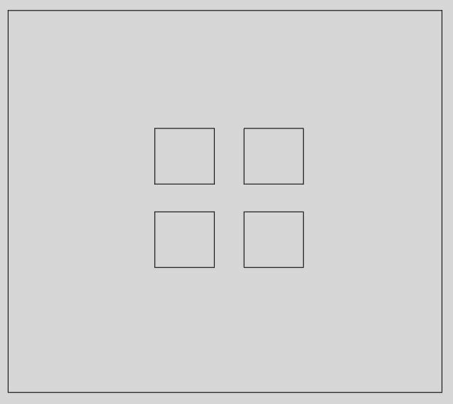

It's an interesting subject. Just an idea.
Result (FACTOR = 2)
takashi
  • Jul 18, 2018 2:44 PM UTC
Result (FACTOR = 2)

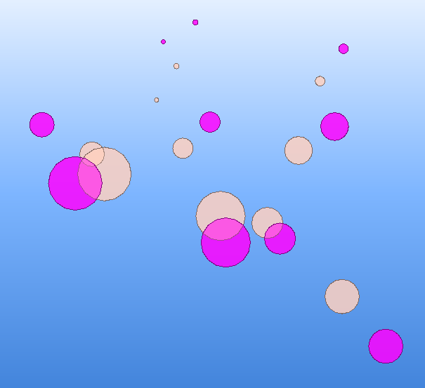

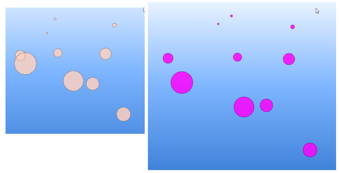

  • Jul 18, 2018 8:18 PM UTC
As takashi said, this is really an interesting challenge.
I built a generic solution where each feature is pushed by its 5 closest neighbors weighted by the inverse of the distance and multiplied by a weight (the radius of a random circle in my case).
Note that in some cases, features may not move at all because the features surrounding them have a null cumulated effect.
The attached workspace generates 10 random circles and applies the solution to it.
Here's an example (before, after and combined):
