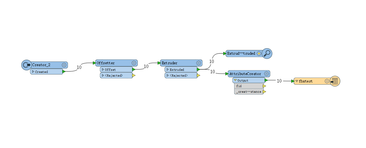

I create a 3d dataset, and work with the Extruder transformer , after that write to a fbx file, I want to set the "fid" filed to this fbx file, how to set?

Hi @keplerleee, according to the documentation, the FBX Writer doesn't seem to support user attributes. As a workaround, you can set the value of "fid" to the geometry as its Geometry Name, if necessary. Have a look at the GeometryPropertySetter transformer.
