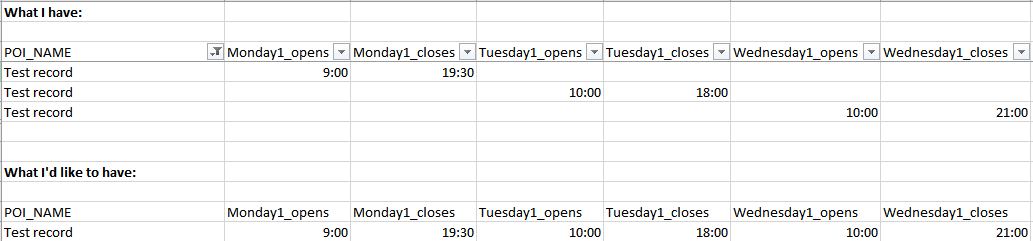

I've used a ListExploder to get some opening hours - I'm now having below problem:
Per record the opening hours for each day are written in a separate line.
I'd like to have all values in one line. How would I bring this data together?

Hi @edhere, try using the Aggregator with these parameters
  • Group By: POI_NAME
  • Accumulation Mode: Merge Incoming Attributes
takashi
[Addition] If the blank cells have <null> or empty string, remove them (i.e. change them to <missing>) with the NullAttributeMapper beforehand.

You deserve a statue @takashi.
Forum|alt.badge.img
Thanks Takashi!
